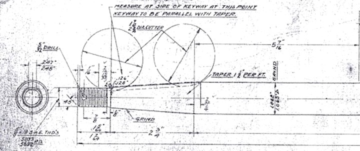

I am looking for a source for a drawing of the ‘26-‘27 rear axle taper, keyway etc.
I am building an HCR and want to make use of ‘27 wire wheels that I have had in stock for a while. I will make an Axle, but need a drawing of the end taper, keyway, threaded ends etc.

Assuming you have correct hubs for T wire wheels ? Isn’t the axle taper and keyway the same for all T tapered
axles ?

Ford print detail of the rear axle taper, latest rev, 6-'25
