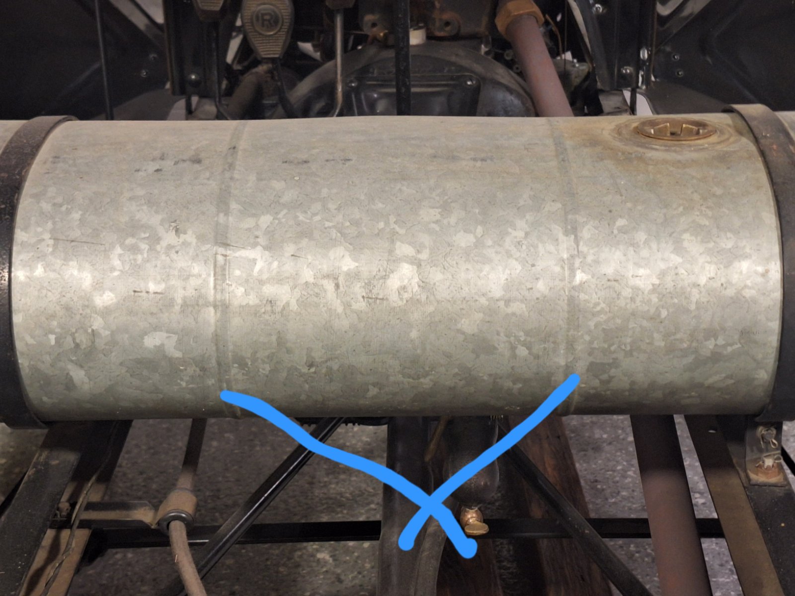

Post by Original Smith » Sat Sep 06, 2025 3:51 pm
My gas tank I believe is original to my 1913 Runabout. The plating is original, and the inside is as clean as the day it mas made. What I noticed yesterday, is there is a nub on the bottom I haven't noticed before. It appears to look like the head on a 6# nail, and only sticks down about 1/32". It is obviously original to the tank, but why is it there? It is almost centered on the bottom.

Do those tanks have an internal baffle of any kind?
Posts: 3954
Location: Lomita, California
Re: Round Gas Tank
Post by Original Smith » Sun Sep 07, 2025 10:26 am
Yes, this one does. I have no idea how many.
Two

Maybe the splash plates have rivets through the shell to secure them, or maybe a dimple in the shell for the same purpose.

Re: Round Gas Tank
Post by big2bird » Sun Sep 07, 2025 11:43 am
Soldered in these two beads.
