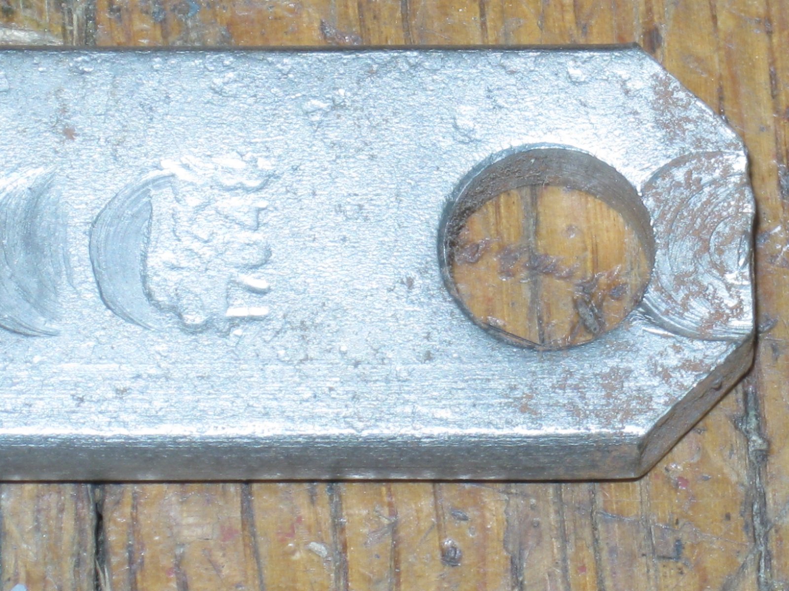

A few more that escaped the final quality checks.
Not that bad just a little "out-of-time" on the punch press, third time is the charm I guess.

Re: Why some N.O.S. parts remained N.O.S. over the years.
Some of my favorites, N.O.S. Crankcase Lower Cover Bolts that seem to have missed a step. I have about 50 of these mixed in with good N.O.S. ones.
