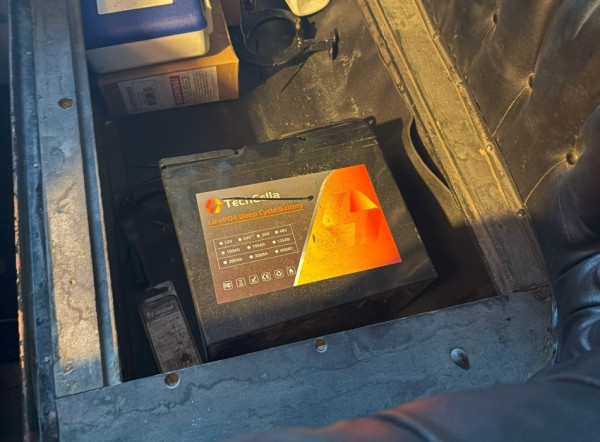

I have a 1914 touring without any magneto or charging system. It came with a 12V lawn tractor battery (size group 35) under the rear seat. Several tours showed that I could drive about 100 miles with about 25% charge remaining, enough for one days use. I was considering options that would give longer duration and a friend with extensive electric trolling motor experience suggested that a deep-cycle lithium iron battery might be a good fit for the Model T.
I purchased a TechCella 100Ah LiFePO4 battery (size group 24) from Amazon. The battery is sealed and can be installed in any position, so fits under the rear seat in my car. I charged it before the MTFCI tour in July and have driven about 800 miles since, the battery is still at 93% charge. This includes some use to run LED lamps and a USB phone/charging port. The battery has built-in bluetooth so I can check the charge state (and load!) on my phone without lifting the seat cushion.
This is a great setup for ignition but it is not compatible with your electric starter. A deep cycle battery is designed to supply a steady load, not the short high current draw of a starter, and a 12V battery will burn out your starter or destroy the bendix drive. One option may be to use the current 6V battery for the starter only, and install a separate 12V battery for the coils. If the 6V goes dead you can still start with the crank. Maybe this will give you some ideas.
Link to battery:
https://www.amazon.com/dp/B0DJ8RSX7W?re ... tle_1&th=1
Link to battery:
