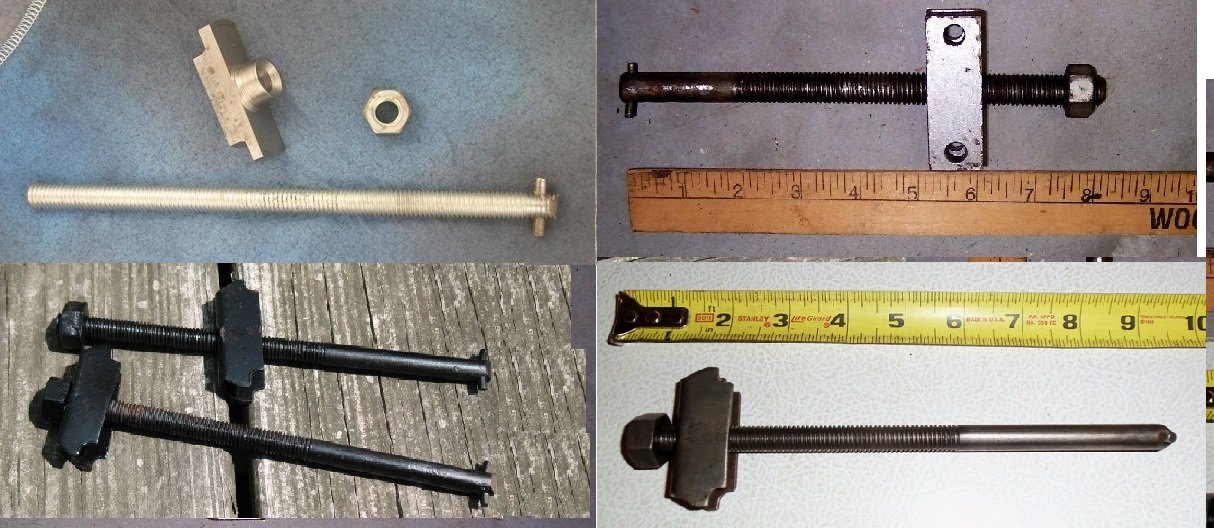

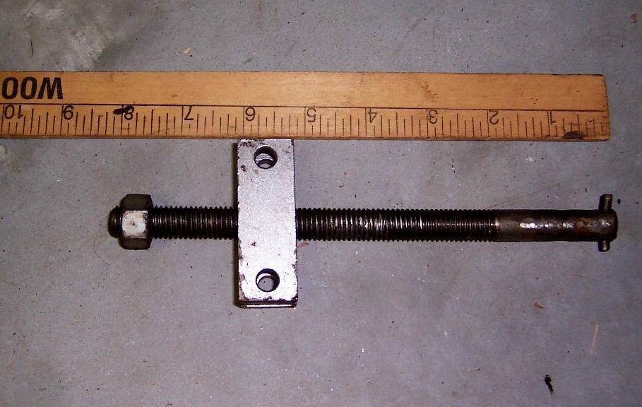

Hasslers came with a dedicated tool to compress the spring. However, you can compress the spring with it in the bracket with a homemade version using a piece of threaded rod, two nuts, a washer and a flat piece of steel with a hole drilled in it as I described here:
https://www.mtfca.com/discus/messages/1 ... 1281825166
And here:
https://www.mtfca.com/discus/messages/4 ... 1398691007

If you make a tool yourself, it doesn't have to be as complicated/fancy as the Hassler factory issue tool.
As I posted above, a length of all-thread, two nuts, a washer and a flat piece of steel with a hole drilled in it will suffice to compress the spring in the bracket.

Thanks , we'll give it ago with a home made version. really appreciate it . Wingnut

As a safety precaution. have some kind of strap around a spring coil & the base its being attached to in case the the tool slips.

A good place for heavy nylon tie straps !

Thanks to all the great advice and tips, we made a tool as pictured, and BAM went together like a charm. Wingnut
