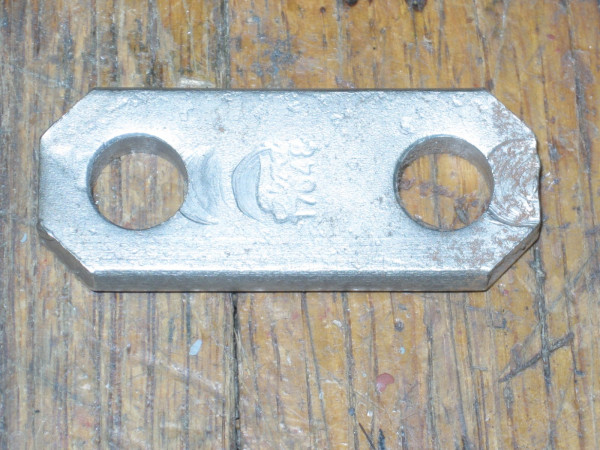

A few more that escaped the final quality checks.
Not that bad just a little "out-of-time" on the punch press, third time is the charm I guess.

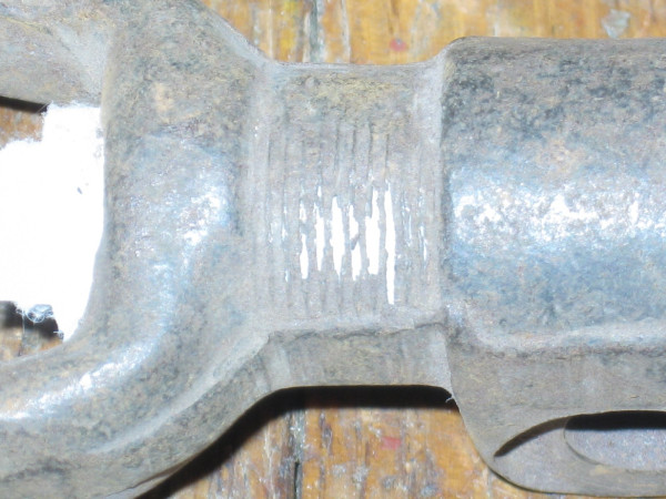

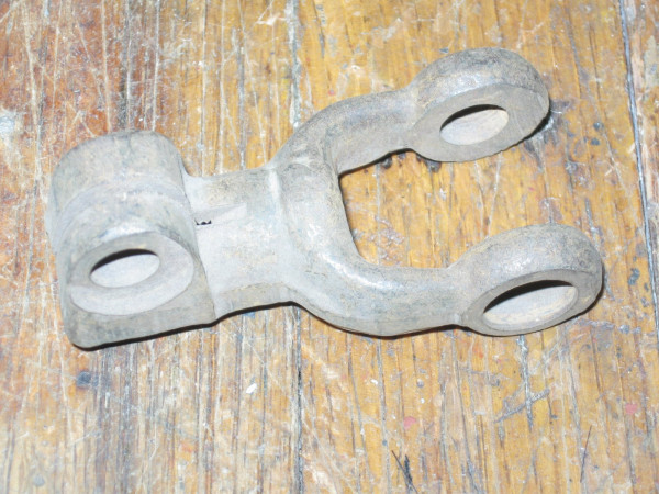

Some of my favorites, N.O.S. Crankcase Lower Cover Bolts that seem to have missed a step. I have about 50 of these mixed in with good N.O.S. ones.

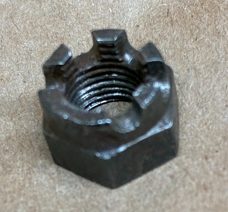

Although not an NOS part, most of us have a bucket of nuts and bolts from disassembling engines, or whatever. That bucket can be a great resource when needing one or more of those pieces instead of buying new ones. The picture below was one such nut that emerged from my bucket. I realize it's not a biggie, however it seems in line with this thread. I'm sure others have come across its sibling.
