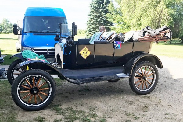

Things were going so good.... After a long delay I finally got the wheels back on my 1917 T today (not the tires, they're next.) Spinning the wheels after I snugged the bearings, I noticed the left front had a little wobble. When measured with a ruler it varies about 1/4 inch. My car has 30 x 3.5 demountables with wooden spokes.
What I need to know is whether the T is safe to drive in this condition while I try to track down a replacement wheel? I really want to go on the Michigan Jamboree in early August and have a lot to do to finish putting the car back together. Any serious problems that crop up might put an end to that plan unless I can find a quick solution.

Thank you all. I feel better today based upon your replies and my own observations. I put an indicator on all the wheels and found the following:
Left front - 3/16 horizontal 1/8 vertical - Right front - 1/8 horizontal 1/16 vertical. The rears no more than 1/8 in any direction. As to snugging the bearings, I drew them snug and then backed them off a quarter turn. The wheels would rotate to seek the heavy spot which was exaggerated because I installed balance beads.
On a related matter, the T sat on it's own wheels and rolled outside today for the first time since last October. I turned it around and pushed it back into my pole barn in preparation for dropping the engine back in. Progress, finally!
Erik, someone in the past installed 30 x 3.5 demountables all around. Obviously they are not correct for a 1917 but a heck of a lot easier to change if I get a flat on a tour.
