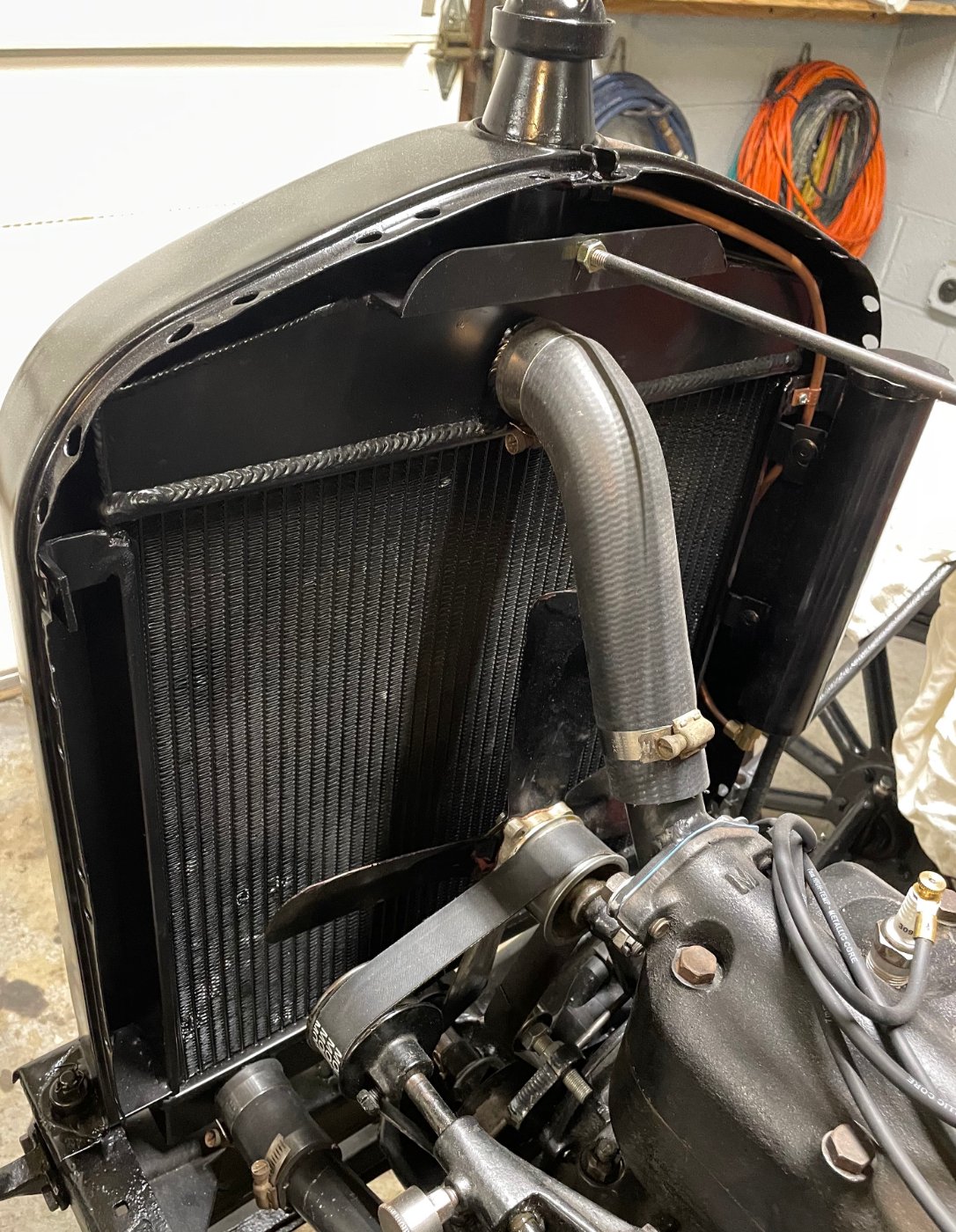

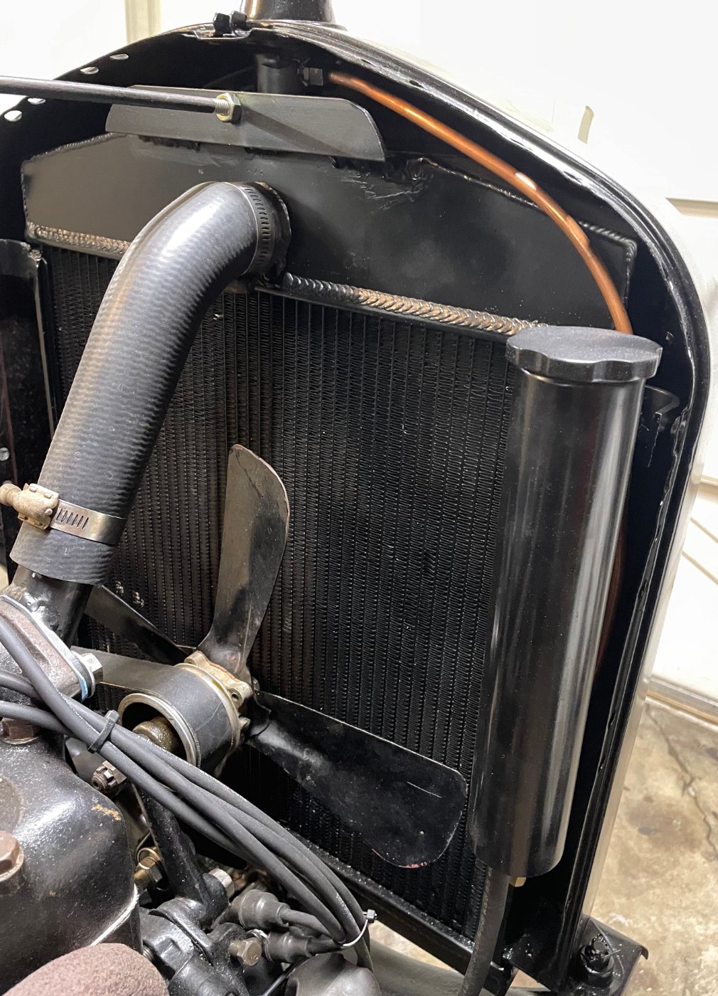

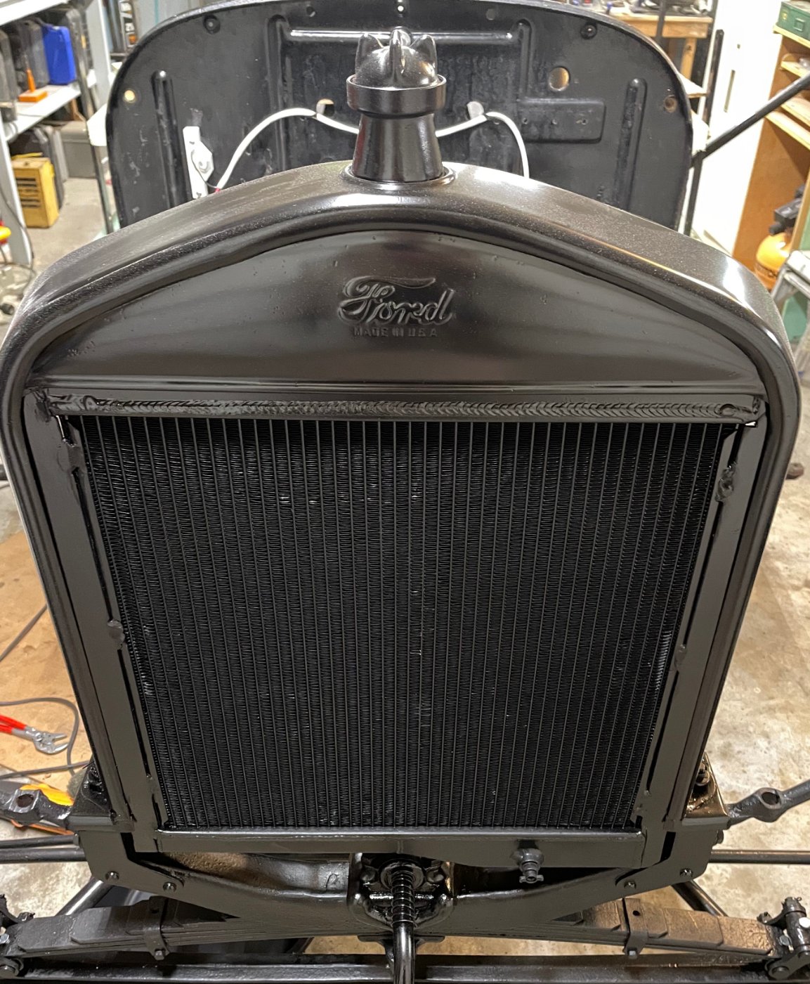

My TT radiator had more JB weld on it than Brass and was leaking like a sieve. It was totally shot. A brassworks rad would be nice but honestly I don't have the money right now. I needed to buy four tires and replace every bushing, kingpin etc to get this thing moving so a period correct rad will have to wait. This is what I came up with for a temporary radiator for my TT. Nothing original needs to be modified so when I can afford to get a brassworks, I will. In the mean time I'm driving this thing as I continue working on it. Total cost was $250 in materials. I realize that not everyone can tig weld themselves so there would certainly be more cost if you had to pay a welder. I started with a $190 Chinese aluminum radiator for a Jeep CJ3. The filler neck was cut off and the hole filled in. A new tube of aluminum was welded in the center for the original fill neck top to mount on. The stock brackets were cut off the side of the rad and new bottom mounting tabs were welded on. A cross piece was welded on the top to attach the upper radiator rod to. A new rod had to be made as the stock one is now too short. Tabs were also welded on to hold an overflow tank. I chose to make a new steel water outlet because the new setup is 1-1/2". I'm using a water pump for now so there is plenty of circulation. I've been on several drives now and had it up to temperature and everything seems to be working quite well and staying cool. If I were to do it again I would use a slightly larger overflow tank. I used a 2" ($26) and probably should have gone with the 3" version for slightly more capacity. I got a 1-1/2" molded radiator hose from Napa ($24) to cut up and use. Some paint and we have a temporary working solution.

Neat solution.

Very nice job!
Do you have a tall or short radiator?

Re: Aluminum Radiator Install $250
It’s a 24 high hood.

I did a ton of research into which rad to use that would fit well and require the minimum amount of work. I looked at pretty much every aluminum aftermarket radiator that is made for cars, trucks, tractors, machinery, etc. I read all the old posts on here as well before deciding on this particular rad. Labor hours wasn’t too bad actually. I did a lot of planning, measuring and sketching before actually starting construction.

Jason how many rows does the radiator have?

I did the same with my speedster. Biggest problem was they painted the radiator with aluminum paint but advertised it as "natural" mine was listed as a 32 lowboy if memory serves. It was fit into a cut down Minneapolis Moline radiator shell so might work for a low radiator?

Three rows.
My criteria was 1. Must have inlet in outlet in correct position already. 2. Must fit within frame. 3. Only modifications would need to be in non water contact areas. (no cutting into internal areas of rad) 4. Look OK from 10' away
https://www.amazon.com/dp/B09QZPSVXD

So far this setup is working really well. The only thing that I would change is going with a slightly larger expansion tank. Probably the next size up.
