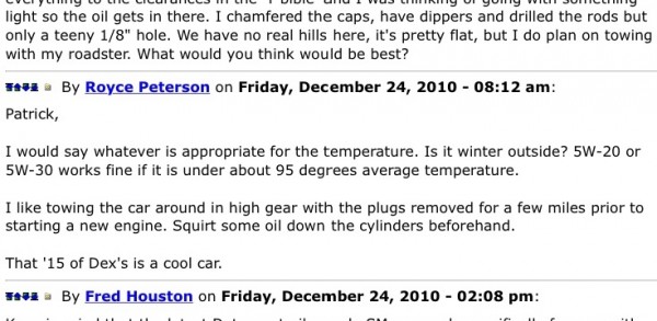

Here is one post that suggests 5w20 oil for climates under 95 degrees ... which is Rochester except for mid August. There were also other posts. I only used it for about a month here this late spring / early summer.

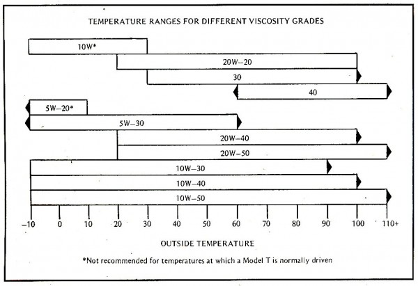

For those who haven't seen it, here's a chart from the MTFCA engine book.
