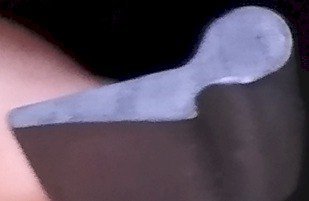

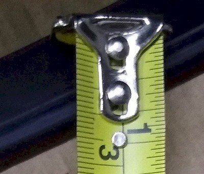

I purchased a bunch of weatherstrip at one time some years ago and am just now getting to the doors. I found this package without any label or part number on it. So, I took photos for help in identifying it. The weatherstrip looks like there is enough to do the leading edge of both doors in between the hinges. But I really do not know where it is supposed to be installed either.
Did not see weatherstrip in the index of the Service Bulletins (did find cowl weatherstrip p377), Ford Service manual, nor Model T Ford Owner.
Looks like to me, the forum says that, originally, Model Ts did not have weatherstrip on the doors.

That rubber strip look like the piece that go in the bottom of the lower half of the 1926/2927 open cars windshield frame. It gives a seal between the cowel and the windshield frame. It would be inserted in the bottom of the frame starting at the small round hole at the beginning of the slot.

That weatherstrip goes on the inside of the door on the glass chanel between the channel and the glass. It seals the bottom of the window when the window is in the up position. If it was not installed when the glass was set in the channel it is too late.

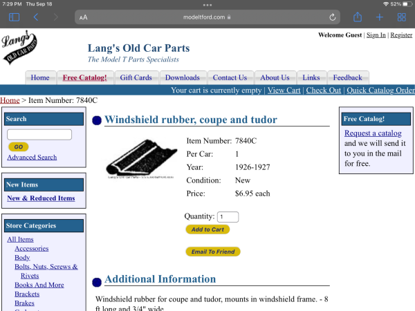

Is this it?
Tom Miller
Posts: 2067
First Name: Jeff
Last Name: Humble
Location: Charlevoix, Mi
Board Member Since: 2006
Re: Weatherstrip doors - what am I doing?
Post by Humblej » Thu Sep 18, 2025 8:53 pm
Windshield rubber is the same as the door window rubber.

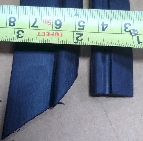

The item on the left is what I used for the windshield.
I remember now trying to install the item on the right into the door glass channel and it would not fit. The problem must have been the laminated glass and at the time, I decided to do without. Maybe I tried the wrong item.
