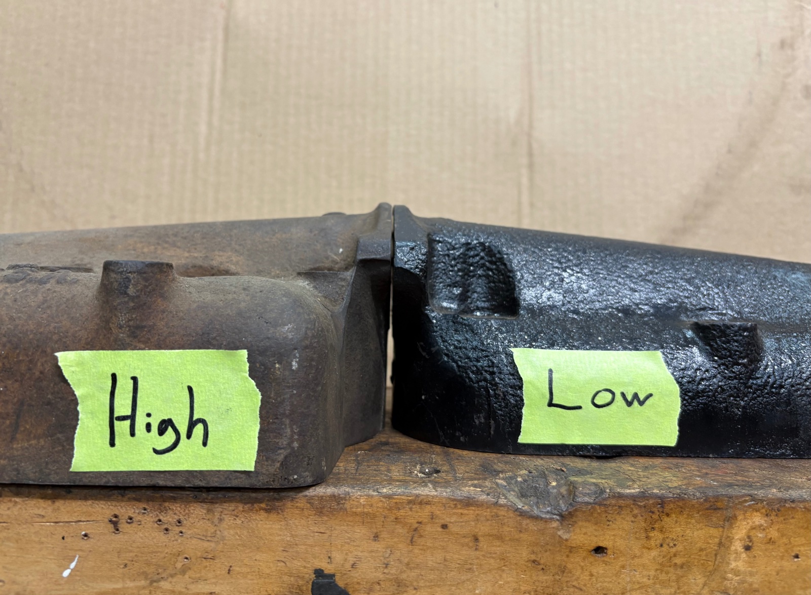

Here is a side by side comparison. The low head has been milled at some point in the past. Just as Wayne said, there really is no difference in the mounting position of the outlet.

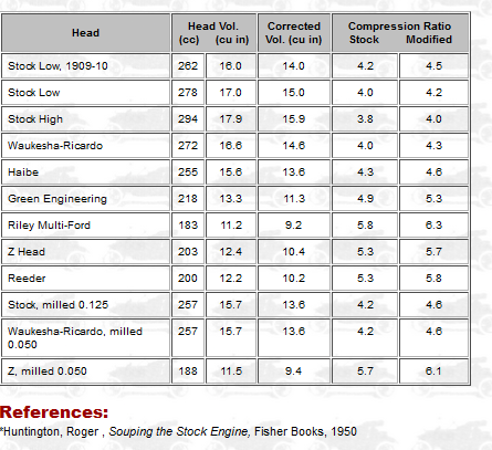

- Posts: 6579
Re: Low Head on a 26-27
Not much difference in the later stock heads 4.0 vs 3.8.
- Attachments
- compression ratios.png (105.87 KiB) Viewed 1121 times
