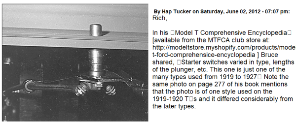

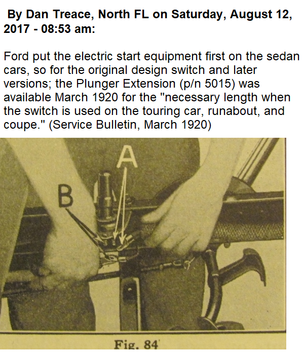

Partial answer: "multiple suppliers"?
https://www.mtfca.com/discus/messages/7 ... 1502458883 --
https://www.mtfca.com/discus/messages/2 ... 1338731135
Notice in this picture the bracket for mounting the switch to the frame is bent to raise the switch. Some repro's have this bend as well -- --
Plunger shown
Plunger shown
