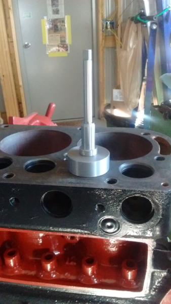

Depending on how steady your hand is, it should. BUT! It would be helped by a plug that is installed in the valve seat hole and held in place with a clamp. I would after reaming the holes, recut the seat and make sure the valve seats 360.

You need a fixture to keep the reamer square to the deck surface. I had 2 valve guides that had broken off and someone glued them back on. It didn't hold up. One of those guides was angled from wear. I installed thick bronze guides to fix it. A friend made a reamer guide for me. There are better designs out there but mine worked acceptably.

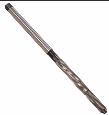

As others have stated, you need a guide to keep everything in line. You also should have a valve guide reamer, (i.e. not just any reamer). They look like this. Notice the leading 1/3 of the reamer has a built-in pilot/guide.

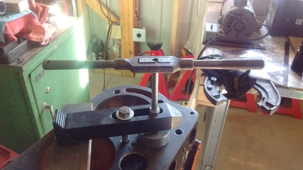

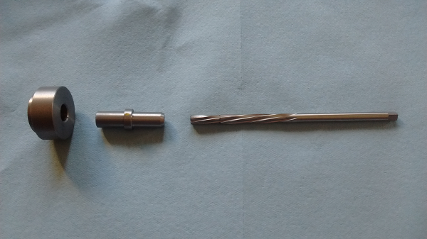

Attached are a couple of pictures showing my 1919 engine getting reamed. The standard .312 valves wobbled around in the guides. The engine machine shop owner who was helping me said the wobble was too much. So I decided to install .327 valves, which required reaming. I asked the machine shop owner do it. In the picture you will see that the bottom of the reamer does not have grooves on it. It follows the existing valve guide, as per the description on Snyder's website. I measured the width of the bottom "plain" end of the reamer and it was made to fit .312. After reaming the first guide he slipped a valve in then pulled it out and a smile crossed his face when it made a nice "POP" sound.

Scott,South Park Zephyr wrote: ↑Mon Sep 22, 2025 2:28 pmJerry,
Can I ask where you found that reamer?
Scott
I did a Google search for "valve guide reamer" and that was one of the first images that popped up. There were many more of the same style.

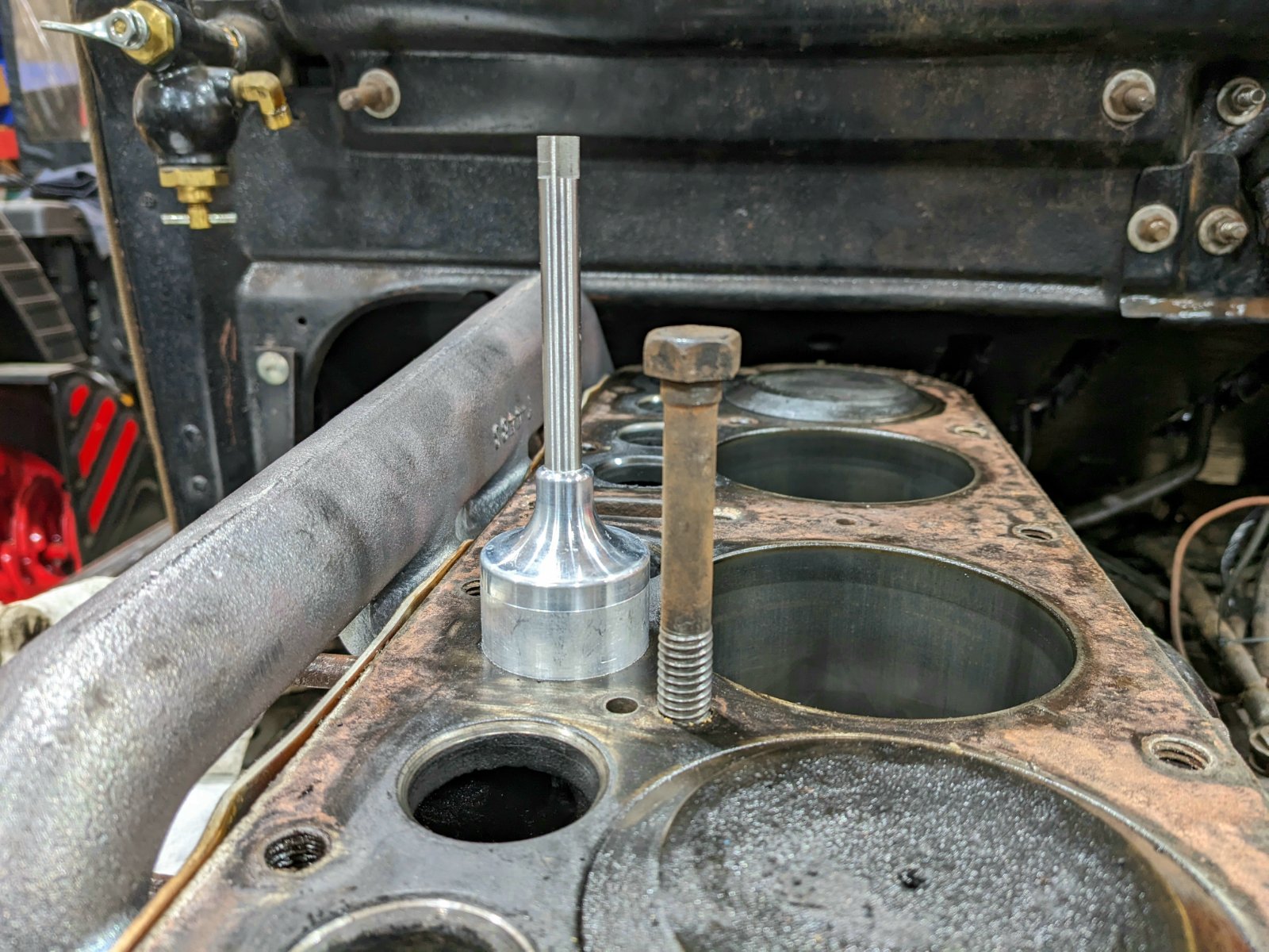

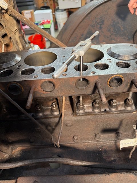

Reamers always follow the hole they are used in. It’s just what they do. Any kind of guide tool would just bind it up. I have reamed countless T blocks out to 11/32” with zero problems. It has to be done in two stages.
- Posts: 6792
Re: Over size valve stems/reamer
either through lack of experience or plain ineptitude, I have never been able to get a reamer to jam with this tool - though it will center the new hole all but perfectly to the valve seat regardless of how worn the original valve guide hole is, and final seat concentricity/clean-up with a Neway cutter is a snap:

In response to two questions, I purchased my .327 valves and the reamer shown in the 2 pictures from Snyder's.
