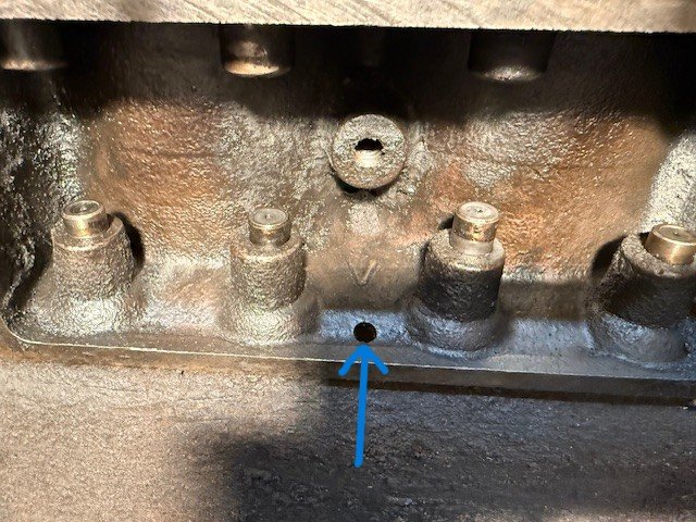

I am working on getting my 1919 center door sedan running after it was put in a barn in 1948. Below is a picture of my block all cleaned up. I understand that the 5 small holes are "steam holes" to allow steam in the water jacket to escape. I have the pan off underneath and I was looking at the very nice crankshaft, lifters and camshaft when I noticed that the two holes marked with arrows in the attached picture go right through into the crankcase. From below I could see light coming through those two holes. Is this correct? Why would steam or water be going into the crankcase?

Those holes are passages for coolant to flow into the head. The gasket also has those holes. No there should not be steam holes into the crankcase, but are you sure that is what you are seeing light thru? There are oil drain holes in the valve gallery that you might be seeing light from. I would take some wire and see if it goes thru or bottoms out in the block for those steam holes. My bet is they do not go thru the block.

Humblej I am eating humble pie. Indeed the light I could see coming through two holes in the crankcase was coming through holes where the bottom of the valves and tops of the lifters are, which is nowhere near the top of the block where the steam holes are. Whew! Someone would need a long drill bit to accidentally drill from the "steam hole" all the way down into the crank case. See picture. I guess some oil splashes through those holes to keep the springs and valves oiled.
