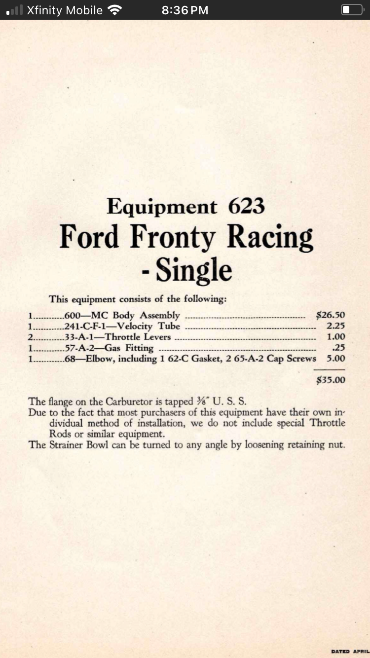

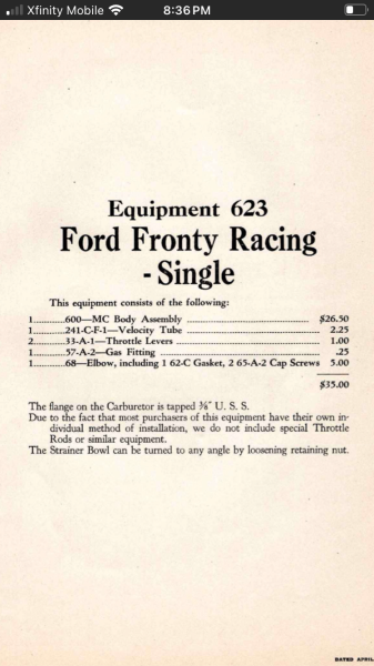

From the ‘28 Winfield catalog;

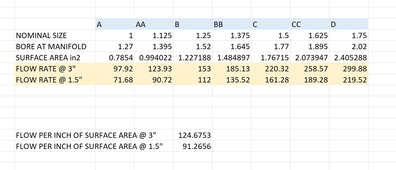

And my flow estimates for the S/SR series carbs. Dual carbs is said to reduce efficiency by 20%
