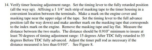

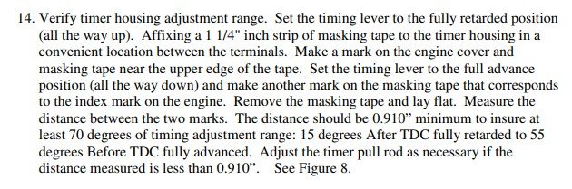

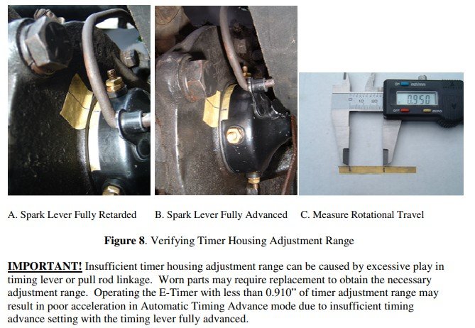

Mike Kosser wrote a simple procedure to verify the timer moves far enough between full retard and full advance.
Basically the timer needs to move at least 0.91" to get full range and best performance on any timer you use.
I stole them and have posted them here.
