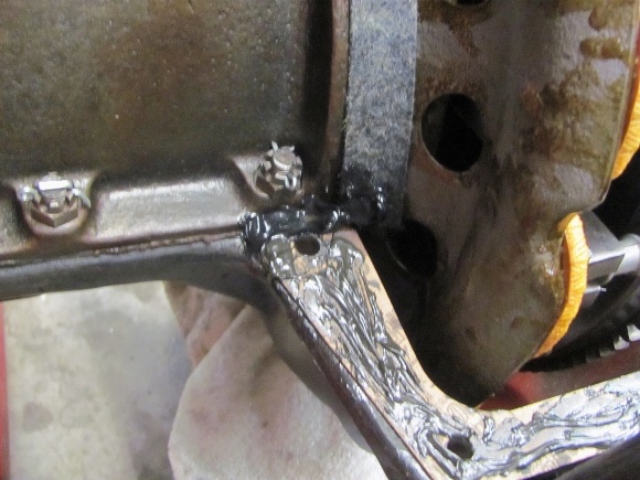

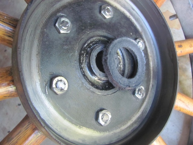

Post by DanTreace » Mon Sep 29, 2025 3:40 pm
The very few places old time felt is used, have rubbed the felt with axle grease. Compresses the felt, and helps retard oils from seeping.
For me the only felts are the rear wheel hub/drum recess and the hogshead felt circle seal.
Old school for me is to use varnish, dip the hogshead felt strip, let dry a bit, then install. The undried varnish will ooze out and make a nice seal, but won't be so stiff, as silicone sealers can be, to allow the hogshead to pull free easy. Add a good dab of black silicone at the corners of the hogshead and the block (where Ford service says to lay a candle wick!) to pack that leaky spot.
All the paper gaskets get a coat on gasket and metal surfaces with good ole Permatex #2., that brand has made the test of time!
Other seals are best done with modern seals at the front plate, a rope seal at the front plate/pan nose, seals at rear hub, inner Hyatt bearing seals, and modern dust seals in the front wheels.
