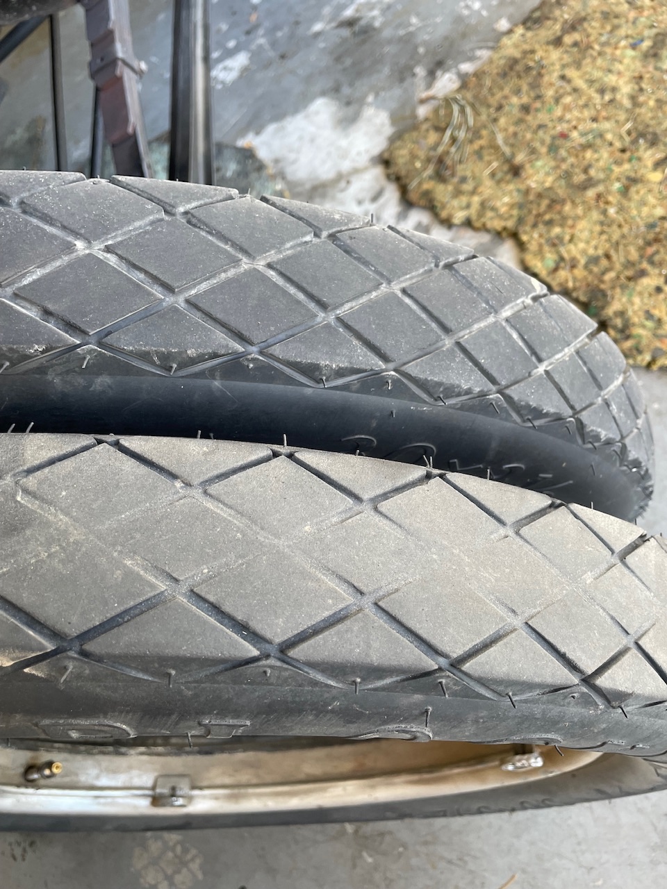

I’ve been told that front tires on Model T’s usually wear faster than rears, but mine are doing the opposite. The one higher in the photo has always been on the front, and the lower one has always been on the rear. All four are Blockleys with about 5000 miles put on them over the last 21 months. I run 60 psi all the way around, and have never seen less than 57 when I check them. Both rears seem be wearing significantly faster than the fronts. The fronts have about .060 - .090” of tread left in the center, while the rears are near zero. The tread depth on the Blockleys I just bought are .220 - .240”.
I have checked the rear radius rods and they are adjusted to the same length as best as I can measure with a steel tape so I think the rear axle is running square to the car. Is there anything else I can check?

Looks like too much pressure in the rear tires for the load they are carrying. The front tire looks normal. My T wears the rear tires faster than the front. Driving habits and traffic conditions will affect tire wear. Excess wear in the tread center almost always indicates too much air pressure for the application. What kind of car are you driving, and what size tires?

It’s a 1924 touring car with 30x3.5 tires, all four installed new at the same time and always run at 60 psi. The fronts are wearing more in the center as well, just not as fast.TXGOAT2 wrote: ↑Fri Oct 10, 2025 4:23 pmLooks like too much pressure in the rear tires for the load they are carrying. The front tire looks normal. My T wears the rear tires faster than the front. Driving habits and traffic conditions will affect tire wear. Excess wear in the tread center almost always indicates too much air pressure for the application. What kind of car are you driving, and what size tires?

My dial gauge matches my 2022 Grand Cherokee’s sensors at 40 psi, and the wear PATTERN is the same on all four, so I don’t think inflation is the issue. I once had a tire roll off the rim on a straight road while inflated to 55 psi (thought I’d been shot when the tube blew!), so I too will never run less than 60 on a clincher.
Michigan roads are relatively straight, and in the attempt to remain on less travelled roads it’s rare to run more than 5 miles without a stop or turn, so it sounds like faster wear on the rear is to be expected, and maybe I should swap front and rear occasionally.

Overinflated tires will show more rapid wear in the center of the tread on all 4 wheels, assuming the car is in good condition. Be sure your rims are in good condition. Many are not.

If you have significantly irregular tire wear, you have a tire problem.

What you are saying about center tire wear is correct for modern tires. Post clincher.
The higher pressure for clincher tires is to keep the tire on the rim. Yes, 60# is way more pressure than a T needs for weight support.
Balloon tires were/are inflated to the appropriate pressures based on weight & passenger load combined. When properly inflated, they wear evenly.
Balloon tires on a T, depending on body style can be less than 30#.
Center wear is inevitable on rear clincher tires as is camber wear on the fronts by T camber specs.
To get maximum mileage, thoughtful tire rotation is in order which can include turning the fronts over on both sides because of camber wear.
Looking @ OP's front tires, I am impressed by the lack of outer(camber) edge wear.

The tire from OP's front shows very even wear.

When I started as a full time mechanic in 1975, a set of bias tires on a modern car were doing very well to last twenty thousand miles in regular driving. That was for a top line tire. Cheaper ones often didn’t last ten to fifteen thousand. We are now used to radial tires that will go close to one hundred thousand miles, while delivering better braking, handling and better gas mileage. Prices, adjusted for inflation are probably cheaper now as well.
The tires in the photos are wearing normally for the use but the mileage seems low for that wear. You might ask Blockley if they have any suggestions as to why the accelerated wear?
