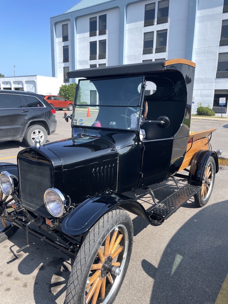

Re: Transporting Model TT with C-Cab
I have transported my "C" Cab truck on an open trailer for quite a few years with out any problems. I remove the hood, & install expandable shower curtain rods on top of the seat cushions and on top of floor boards, also a ratchet strap hook in each door hole where rain curtain rods would go. Strap down vehicle normally and down the road you go. Safe & Sound
