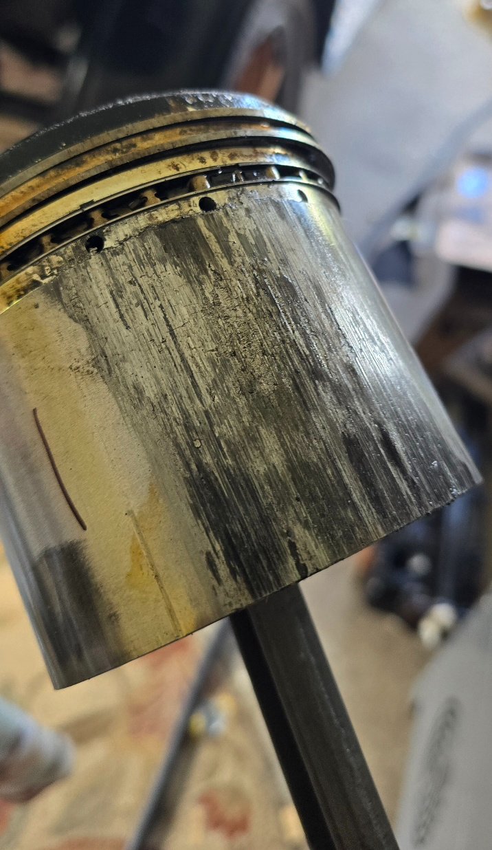

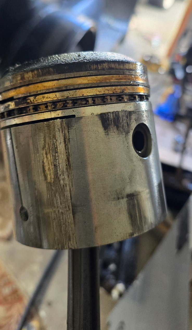

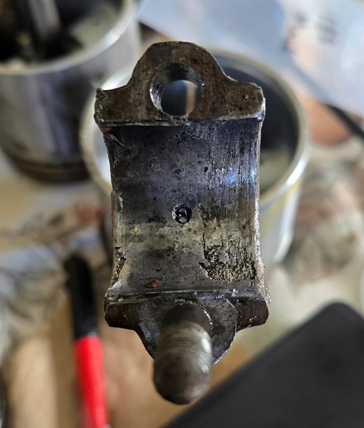

Babbit looks new on all except for piston 2. Piston 1 skirt looks like wtf happened here?
Follow the link and let me know what you guys think please!

That rod babbit looks similar to what I posted two days ago about a number two rod babbit failure. Art

The piston is scored badly. The cause could be improper piston or ring fit, a bent rod, piston pin too tight, or lack of oil. Overheating is another possibility, but given that the #2 rod bearing is completely burned out, I suspect improper fit/installation issues, or someone ran the engine without oil, or someone put heavy oil in a newly rebuilt engine and fired it up on a cold morning and raced it to "break it in right". It looks to me like you will need to do an in-chassis overhaul at the very least. If no reliable history is available, it would probably be best to remove the engine/transmission assembly and ship it to a competent rebuilder, unless you are willing and able and equipped to do the work yourself. The car looks good, from what I can see, but it certainly looks as if engine work was not done correctly, or the engine has been abused in some way, such as severe overheating or run with a lack of oil, or run hard after a rebuild without proper break-in.

I had a T motor come in seized. Primarily from head gasket leaks that rusted & stuck #4 piston.
During the tear down & rebuild I discovered #1 piston & bore severely scored. (original iron pistons)
Fortunately babbit was savable with shim removal & time saver.

Someone may have fit aluminum pistons to the original Ford spec, which is for cast iron pistons and is too tight for aluminum pistons. New pistons in a worn and out of round bore can also cause trouble, as can new pistons fitted in a tapered bore. Model T transmissions have some critical fits, and if the engine guy also worked on the transmission, it probably needs to be assessed.

It needs to come out and apart.
It boils down to budget and skill level, which includes tools.
On the other hand, stock motors are quite forgiving. I've seen stuff that should not run, run fair.

The piston being scored along with poor babbitting , Basically engine overheated or parts weren't sized accordingly. Babbitt of the rod wasn't tinned and it is lead based babbitt.
