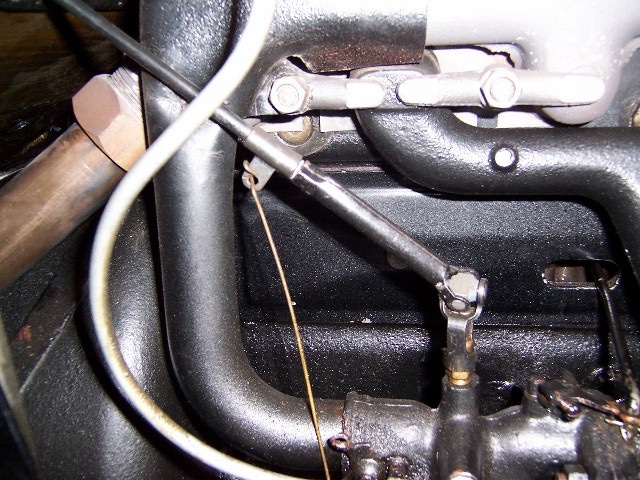

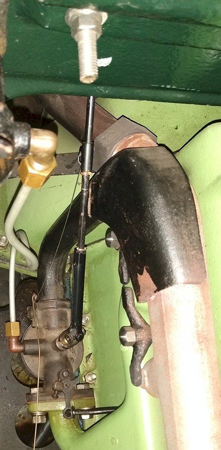

Mike, I just had to deal with all this on our Coupe. I believe the two bolts mounting the carburetor to the intake manifold are 3/8". You may need to loosen them, rotate the carb. so that the screw closest to the engine goes up, and that the screw closest to you goes down. While holding the carb with some channel locks wrapped in a shop towel, hold it in this rotated position. Then with another hand use a 9/16" open wrench to hold the screw and with another hand/9/16" open wrench, tighten the nut. A little bit of rotation is magnified by the tall mixture adjustment needle.
I had gouges in the hot air collection pipe it was so close. I also, with a high speed mini grinder, removed 1/16" material from the hot air pipe where it contacts the exhaust manifold.
I also relocated the slider higher up on the choke rod by drilling holes to a new location.
The rod itself is sold longer than you need. The installer is supposed to cut it down to size. That is why it sticks out the dash. Ours no longer does stick out.

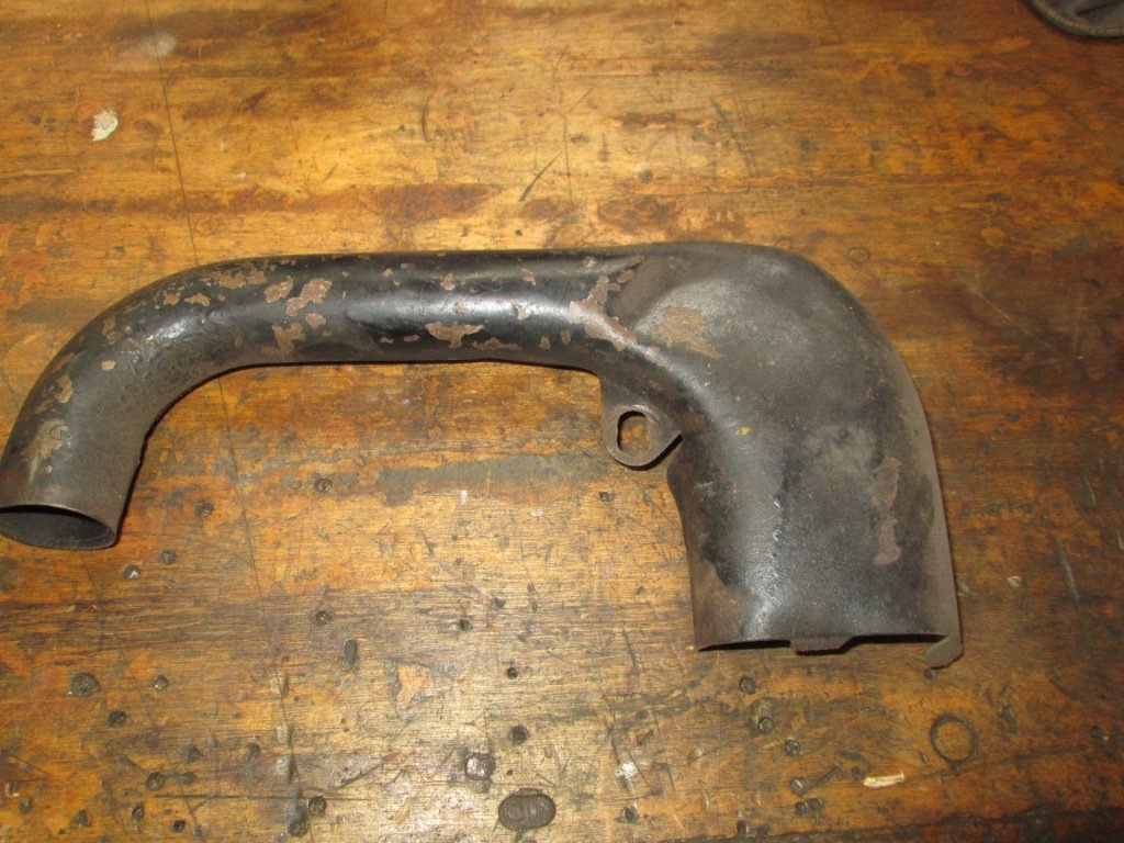

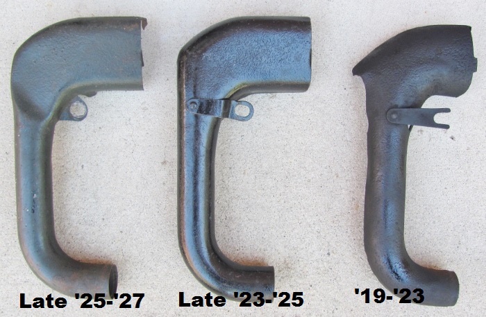

If the combination mixture/choke rod was replaced, most likely with a repro, one drives out the tension pin holding the adjustment knob, shorten the rod as needed, reattach the knob, redrill the hole & reinsert the tension pin.
Ford supplied a "special" hot air pipe with indentation for the swivel top carburetors so as to not have that interference issue.

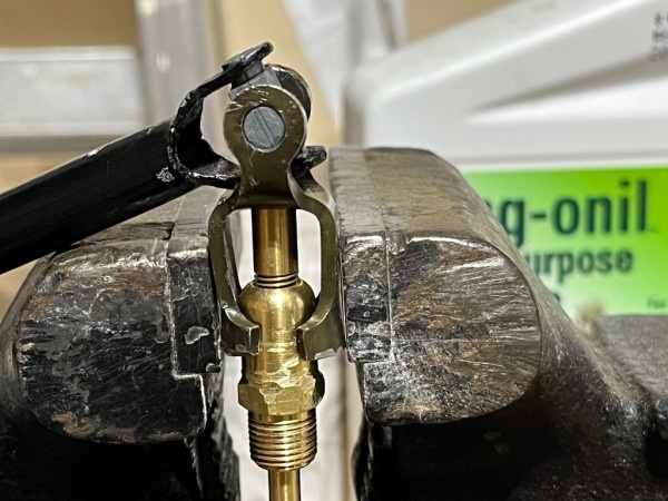

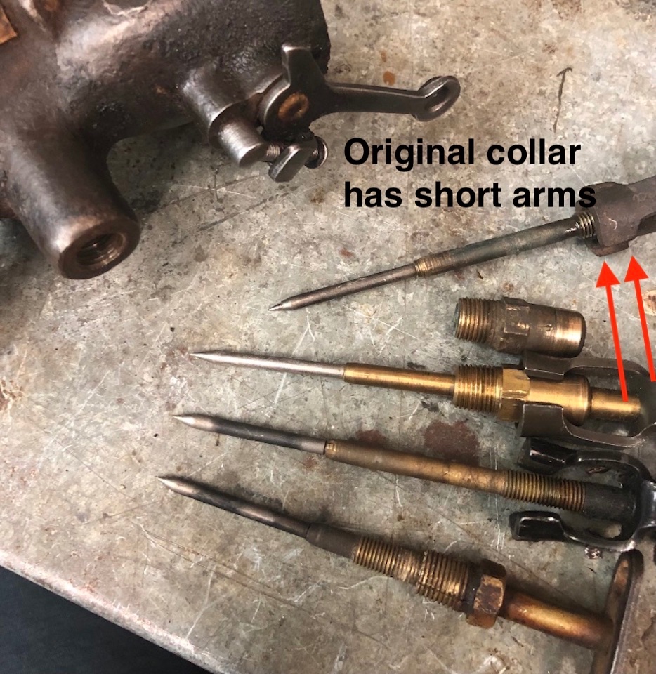

For the repro needle valve, that replacement has longer arms or fingers than the originals (provides the tension on the round barrel to keep the needle valve in correct spot) can interfere with the hex portion and prevent full seating of the needle.
My fix is to cutaway a portion of those arms (neat job no, but results are right :( )...... just another thing with repro parts. Cut back the arms improves function, be sure to crimp the arms just a bit to get the proper tension to prevent drift.
modifed repro parts.jpeg (99.64 KiB) Viewed 1130 times
528269 (494x500).jpg (95.99 KiB) Viewed 1130 times

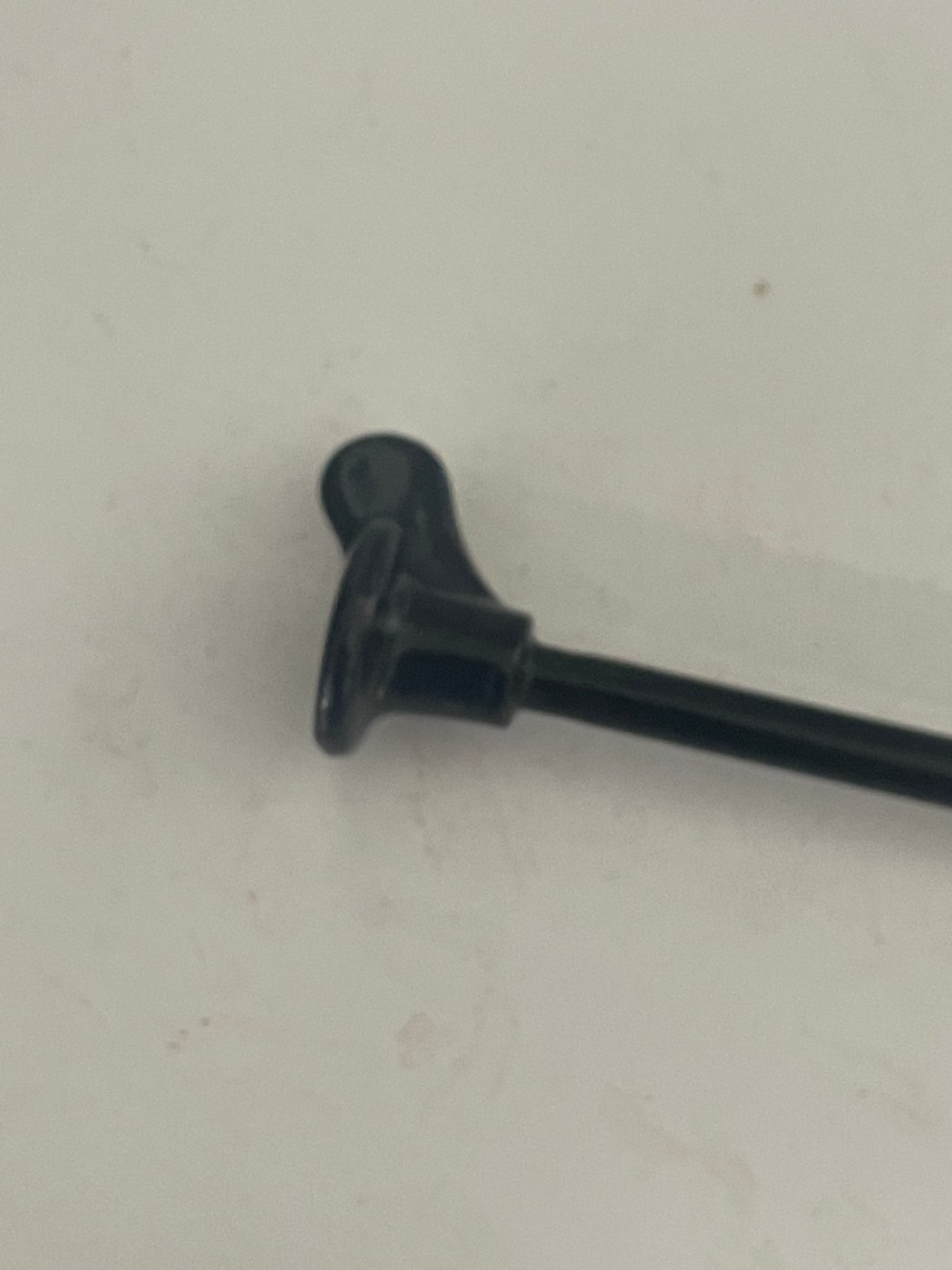

Obviously, the previous owner put this in without using the correct part. Two issues, the knob at the top is not removable to allow me to cut the rod and replace the knob so I am ordering one from the parts suppliers that now love me! Photo is attached. The rod is 28 7/8 inch long.
I found a Model A repair manual in the car after we got it, so obviously this part might have been for a Model A.
The second issue is that the first hole in the rod is 4 3/8 inch from the tip which puts the gizmo that the choke connection attaches to which puts it in the center of the manifold. I need to either replace the whole thing with a new rod or drill new holes, cut to the right length and put a new knob on the top.
PS - the square portion of the rod is only 1 7/8-inch long.

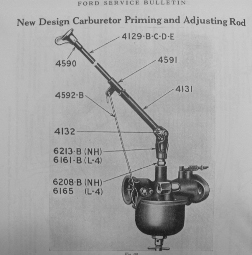

The vendors sell a replacement that is long and you cut to length, the knob is held with a split type pin. That is what you need.
Perhaps your rod is for the Vaporizer Carb adj. rod and knob assembly, for the Fordor it's 29 9/16"
The rod for your 27 Coupe is either 4129F, 27 13/16" or the 4129G , 26 1/4" long and the square section is longer too.
Vaporizer rod shown in this photo, choke arm higher.
NH rod with choke arm lower on the rod. Rod shown is the vendor version, sometimes needs a bit of tweaking to the square shaft to slide easily in the square tubing. Filing a little. The goal is a nice fit, but keep from rattling too, the square end long enough to slide up for full choke movement, but not too far that the end of the rod pulls out of the square tubing.
