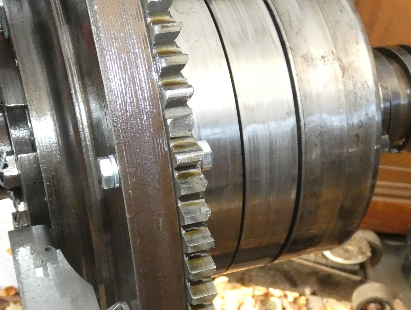

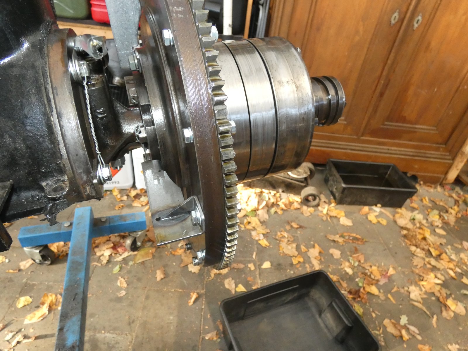

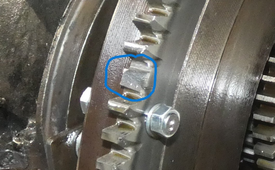

Hey all,
Last week I was called for a knock during the start up of an engine I rebuild two years ago.
Engine is running great with no noice and good perfomance.
Here is what I found:
The flywheel ring gear was replaced during the rebuild.
Together with the missing tooth, the starter gear is gone to.
Andre

That ring gear is toast.

It's early, but the proximity to that nut ...........

I bet that’s it! The balance ring on the bendix gear is hitting the nut and crashing / skipping the gears.
He did say he installed a new bendix. They have a solid machined one piece gear and balance ring. If it was an original bendix gear with a swedged balance ring, those nuts would have broken the balance ring off the first time the starter was energized…
- Posts: 5246
Re: Knock during start up.
I agree. Its them nuts. The bendix gear will engage to the flat face of the counterweight.
Look closely @ the nuts for damage marks.

Andre, if you ditch the magneto, retap the ring gear 1/4"-20, and use bolts and lockwashers all the way around the gear, short enough to be flush on the drive side.

I don't see any damage to the nut.

Andre, when you removed the magneto, did you install some paddles for oil?
I used 4) 90* apart. Short pieces of 1" angle about 3" long. Been a long time. Vendors have them if you want to see a picture.

Wow. Those are rather large.
- Posts: 5246
There were similar slingers from a south manufacturer of T parts that fatigue & come apart.
Has that problem been cured, or will it be the reason for the next tear down?
- Posts: 8636
With the Ford magnets in place, the number of magnets reduces the amount of pressure on each one of them as the assembly spins. Each magnet is in the "shadow" of the next one. With 3 or 4 steel vanes, each one gets a better "bite" on the oil, and probably has a lot more turbulence to deal with. I'd think that more, and smaller, vanes would be a better arrangement.

The bare flywheel moves plenty of oil without any slingers. If you really don’t believe that and think you need something extra, just put the aluminum magnet spacer spools on the front of the flywheel with each ring gear bolt. The paddles you installed do fail in use and cause major damage. They are also hydraulic resistance which you are trying to eliminate by removing the magnets in the first place.
- Posts: 8636
You want to move oil, but you don't want to build a fluid drive that hydraulically couples your flywheel to the block and hogshead.
