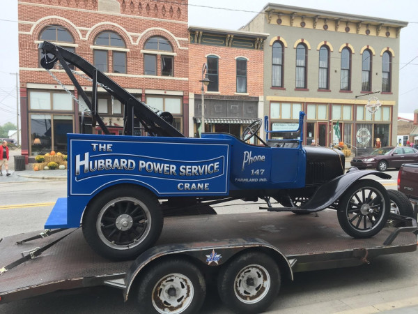

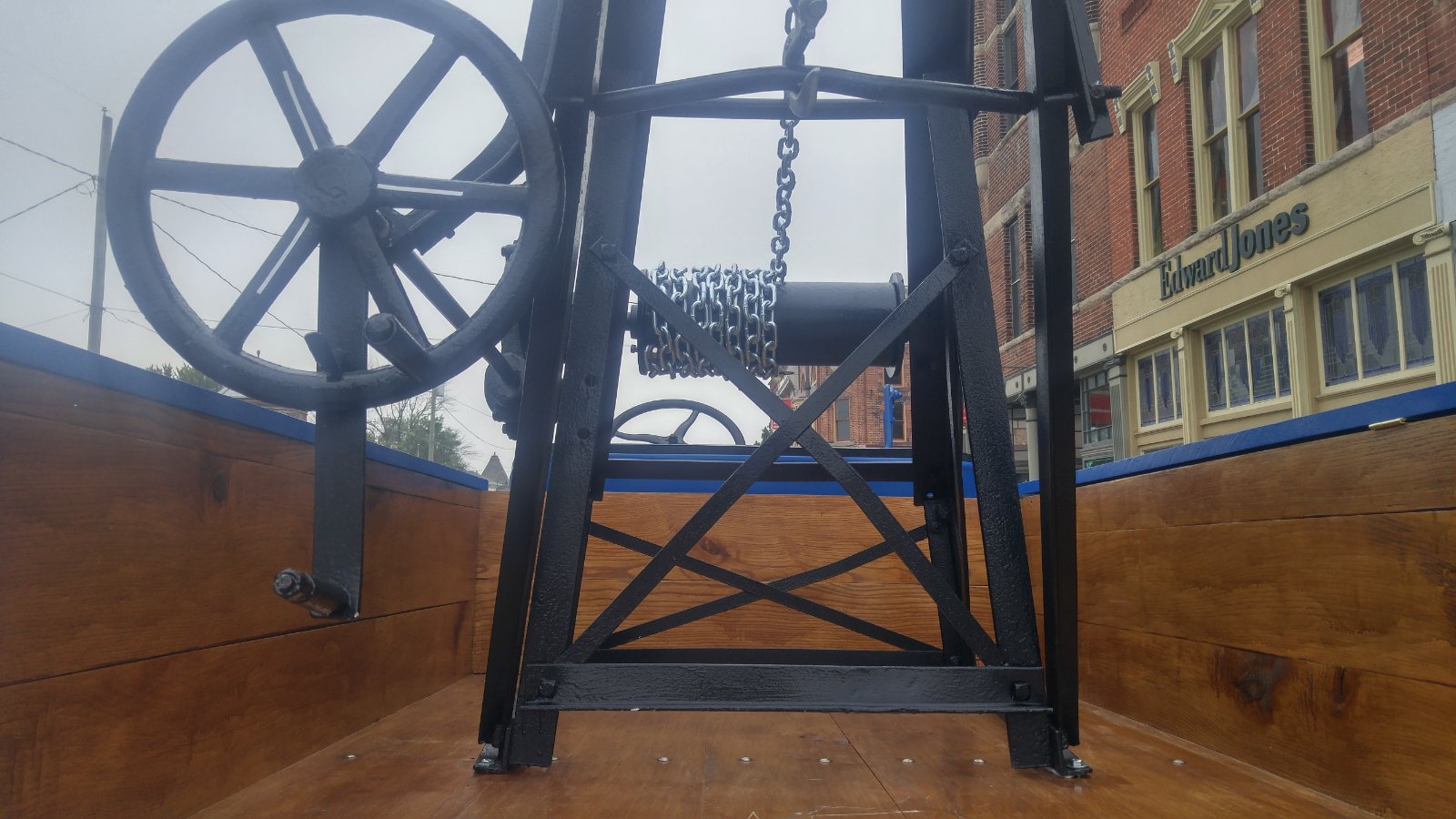

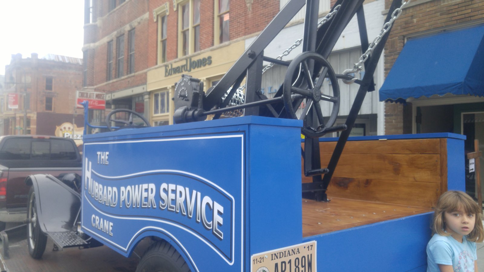

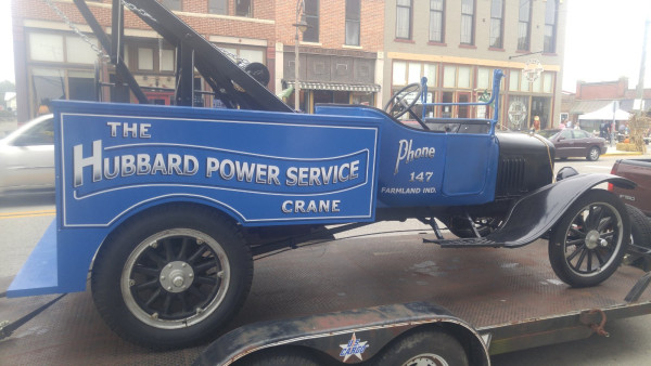

Boy oh boy where to start. First of I own the building where that wrecker bed was made and have several hundred pictures available. They were made in Farmland Indiana and the fella I got everything from was a grandson to the original builder's. They made wrecker trucks up into the 80s. I will see if I can add some pictures that I have of some of the restored or as built trucks
