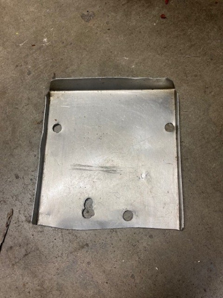

I just checked the rods in my speedster because it sounded a little rattley with a load on it. Took some shims out & sounds great now. Anyway
I made a plate to fit in the pan to catch anything dropped when removing # 4 rod cap, good thing because I dropped both cotter pins. Wont help
in the trans.
Craig.
