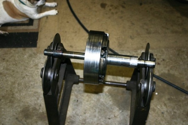

Over the part few weeks I have had my 1926 engine apart for an bi annual inspection. I decided to try and improve the balance of the engine. I'm using a static grinding wheel balancer. Last year we cleaned up this balancer and installed new bearings. It is very sensitive. I tried my crankshaft and found that it is pretty well balanced. The flywheel, triple gears and magnets were a different story. After a lot of work these items were balanced pretty close also. The triple gears were about 15 grams heavy to light different. The magnets were all over the place. Then with the flywheel, magnets & gears assembled with the crankshaft, my static balancer indicates the entire unit was about 7 grams out of balance. I drilled a little into the back of the flywheel and now it will spin and stop randomly or at least as close as my balancer is concerned.
Today, I thought of trying to balance the larger parts of the transmission. I bolted 2 input shafts together and checked them for balance. I put some index marks on the brake drum and placed it on these shafts. The balancer indicated that it was out by a little over 5 grams. Since the shaft and drum are not connected I rotated the drum on the shaft to verify that the test shaft was not affecting the balance. My question is where is the best spot to remove material on the drums so as not to weaken them.
Once the brake drum is as best as I can get it. I thought that I'd add the low speed drum, tape them together and do the balance again. Then finish up with the reverse drum. Maybe I'll worry about the clutch later, after I think about it some. Thanks Mike

Something else. My method of determining how much the assembly is out of balance is to tape a known weight to the light side of the assembly. Seems to work. My question then is, how about adding weight to the light side. I thought of brazing, but am concerned about damage to the bronze bushings. But , what about laying in a little solder. I could then weigh out what I need and get it rather close. Mike

Thanks for the help. I think I'll stay away from the solder. I was a little concerned about applying heat to the old drums. I think the adding nuts and bolts may be a good idea. So far I've been taping small washers onto the light side of the drums to test the balance. I'm having a little trouble. Seems when I test just the brake drum (without the drive plate) I get an out of balance of approx 5 grams. BUT, when I test the brake drum with the drive plate bolted on there doesn't seem to an out of balance. At first I thought great! But then I added 5 grams here and there and that didn't affect the balance at all. The difference is that my balance shaft for just the drum is 1" dia where as the drum and plate the effective shaft dia is 1.5". This changes the ratio of the shaft to balance wheel from 6:1 to 4:1 and probably the sensitivity also. So, I'm thinking about making a shaft that will fit the drum and plate combination. It will have to be machined in that the plate bushing is smaller than the drum bushings. Thanks again, Mike

Here's my setup,

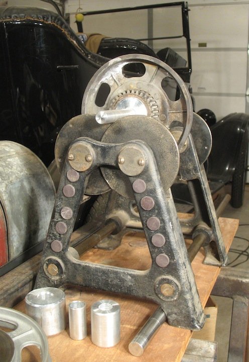

I noticed in Steve's picture (I'm assuming that is Bender's balancer) that there is one shaft and a couple of adpaters that slip on to the shaft for each different drum? Can to tell me what diameter the shaft is? I believe I should make those pieces, it may make my work easier.

I think I repaired the problem, regarding the brake drum and drive plate problem. Seems one of the balance wheels started to drag a bit. Cleaned it up and oiled it and now it works like it should. Mike

The balancer is Steve's but I have one much like it. To answer your question on balancing shafts I made one for each drum. I have found that finding the heavy side of the brake drum and drive plate and putting them 180 degrees out really helps in balancing them. I set up the brake/drum as a unit and then balance. Hope that helps.

I have two shafts, ⁵⁄₈" and ⁷⁄₈". Both work OK. I think I made the larger one then found the mandrel for something I wanted to measure would require a smaller one to fit. I made the shafts from an old junk axle shaft. All the mandrels and shafts were done on a borrowed lathe at the local juco machine shop.

Well..... over the week end I had some time to make a shaft and a couple of donuts
Today, I found some time to first try these.
This should make balancing a lot easier. THanks for the help
Mike
