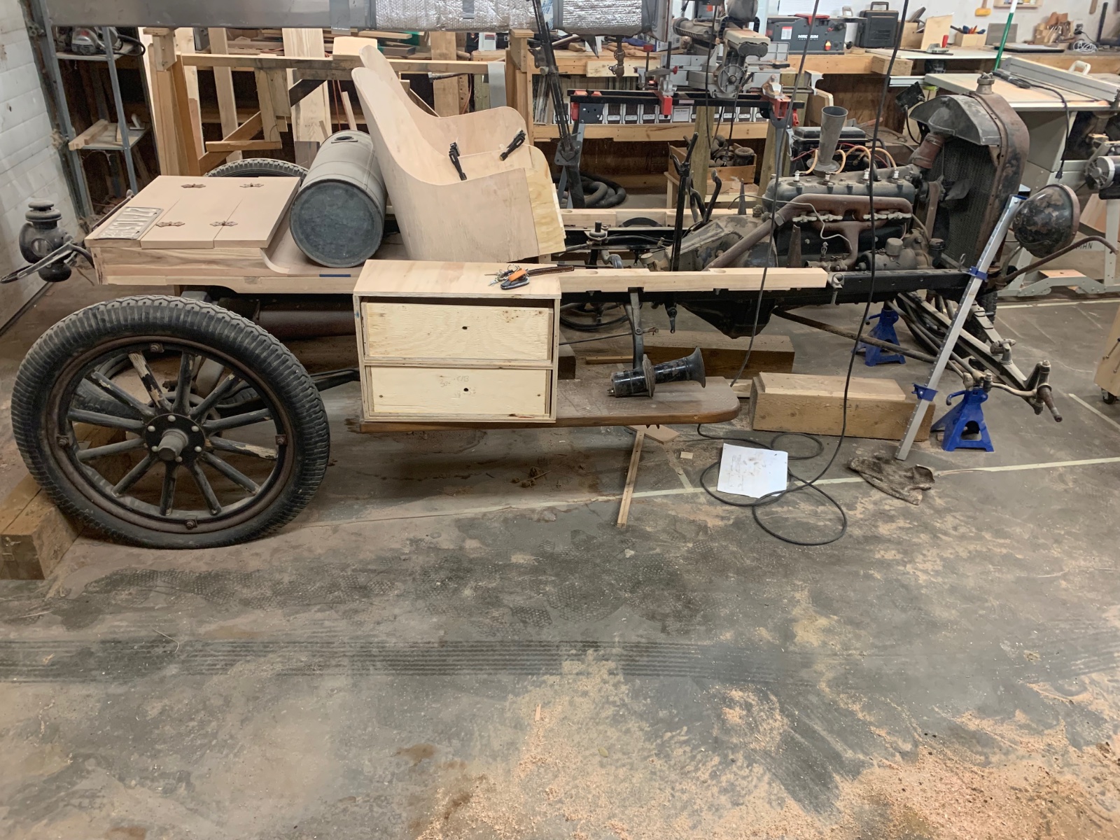

I’ve been a frequent lurker and infrequent poster for a long while now. Months ago, I made the choice to pull the engine on my car. The initial plan was finish the body, drive it for a “bit”, then do all of my mechanical work later. And I simply don’t work that way. If it means another year or two off the road to do it right, so be it.
For context, I bought a running chassis in Spring 2024. I’ve been building my own speedster body since then, which has been the thrill of a lifetime. I’m about 80% done the body, but have reached the point of needing to tackle mechanical work while the body is in the state it’s in. I’m comfortable with disassembly, reassembly, etc of pieces, although I don’t do machining, metal work, or welding as of yet.
I’m curious as to what kinds of cans of worms the forum population has experienced when pulling an engine. Does everything lead to rebabbiting? Does everything lead to new triple gear bushings? Are cases of adjusting bearings and a few other checks normal? Does anybody open an unknown engine and go “wow. That’s actually not bad!”?
I’m not looking for shortcuts, simply stories and experiences of what can happen, typical or atypical, in pulling and opening up an unknown engine.

One thing that's not obvious. Check crank end float before you start.
If it's under about 0.010", things are looking good.

I'd run it. That's the best way to assess your engine, magneto, radiator, ignition, carburetor, etc. It's best to run it in a drive-able chassis, but running it several hours in the frame will be revealing. With rear axle and wheels in place you can get some idea of how the transmission performs, but driving it would be better. Run it with clean 5W30 detergent oil in it and ThermoCure cooling system cleaner in the radiator.
In building the body, I'd want make clearance available for removing the cylinder head and accessing the crankcase dip pan and transmission cover and other service points without undue difficulty.

Pat is right about running the vehicle to determine the overall condition of the various parts ... assuming that there is no obvious conditions present that dictate caution ...you will likely want to do some disassembly to service the thrust washers in the rear axel and to check condition of the bearings in the engine ... i would suggest that too many people imagine that extreme precision is necessary in a Model T engine/transmission unit ... you have probably read of pistons sleazing and rods burning out ...most often due to TOO LITTLE clearance not too much clearance ...you can build your car using your head and hands and good judgement or you can build with your check book and the advice of others ...the photos indicate a high degree of craftsmanship and care in the wood body work ... continue on that path with the mechanical ... careful care with alignment and fit will yield good results ...a vision of the end product will guide the build ... if you want a practical era correct speedster you have a good start ... if you want a NASCAR racer you may want to update to a more current model ...Gene French

Thank you all. I so feel both enlightened and calm after reading the replies.
The notion of too much clearance is often better than too little is something good to remember. As well, thinking of the entire system as a whole is something that I could have overlooked.
My magneto field coil ring (rebuilt by myself) has got me thinking: has anyone ever had their flywheel magnets contact the field coil ring poles while in motion? Does that necessarily lead to catastrophic failure, or can it be a gradual series of squeaks, wear, resistance, etc.
