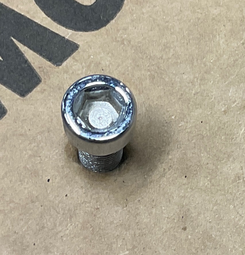

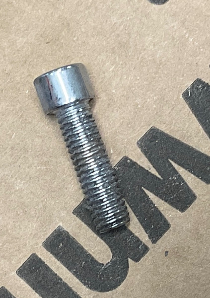

Copied Ralphs suggestion back when it came up, it worked fine. Allen wrench holds the screws and makes it easy to snake them in.
Several months ago I was going to get another set and decided to get some for friends as well. I got 50 of the metric screws and 12 long allen wrenchs from Amazon for about $20. Kept a couple sets for myself and passed the rest out to friends.
