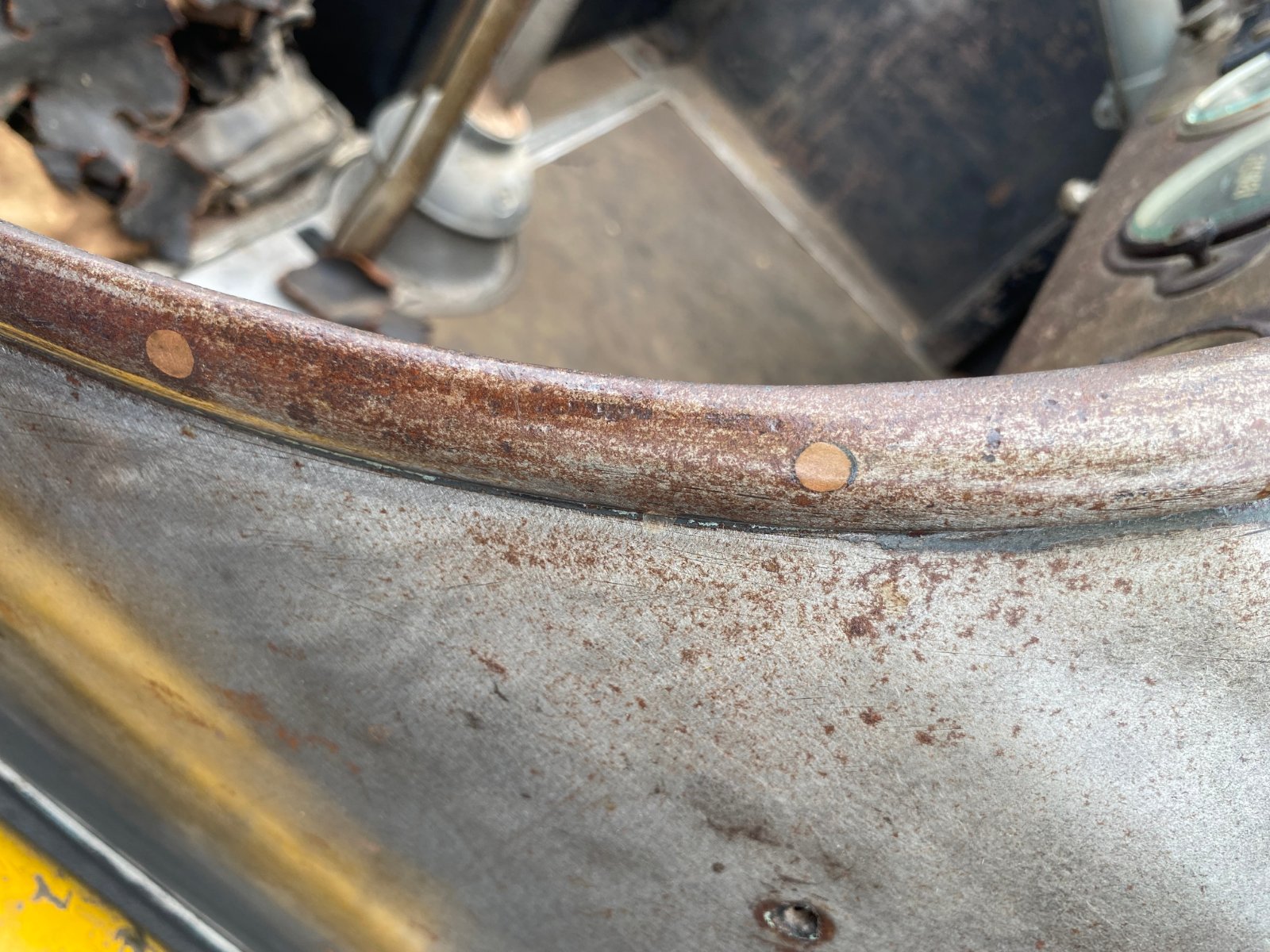

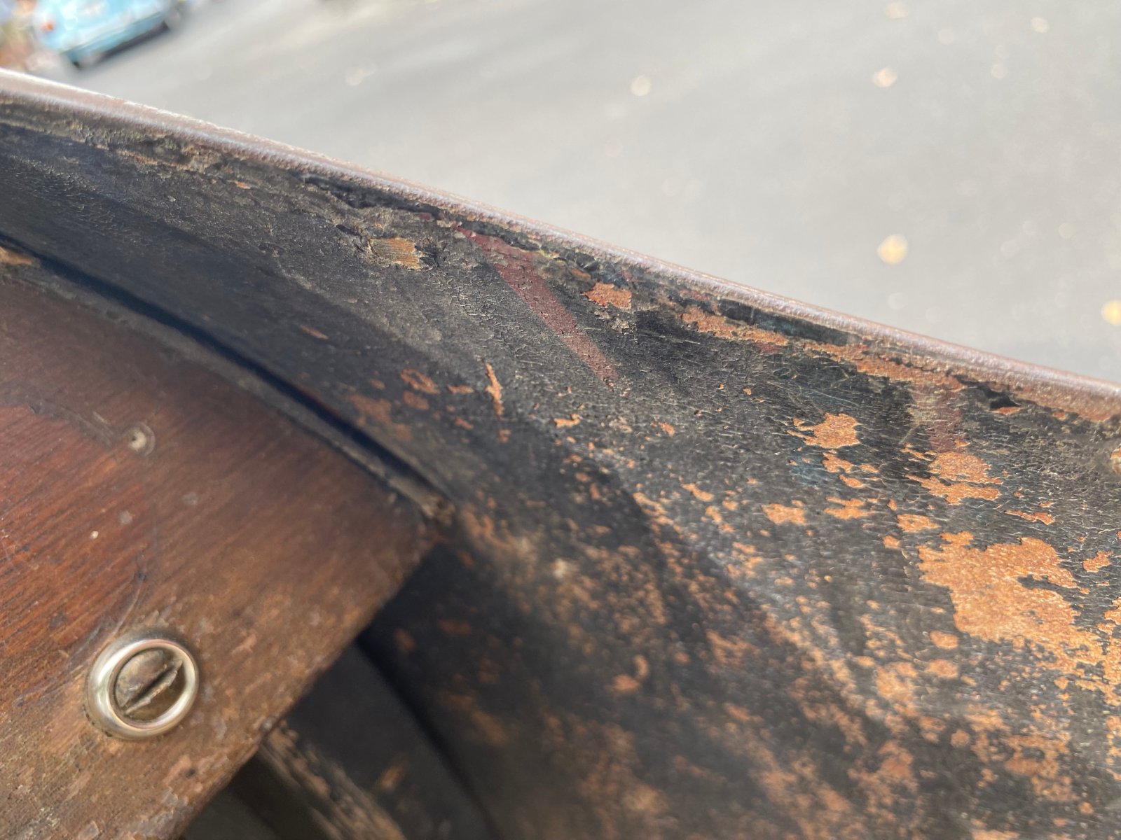

In the Orange field at Hershey were two 1922 Mercers. On the semi restored Mercer was a 1/2 oval steel trim riveted along the edge of the cowl. Looks like brass or copper rivets. See photos. This was typical for a 1920's era car and used on one of my original speedster bodies.
I anyone aware where to get this type of trim?

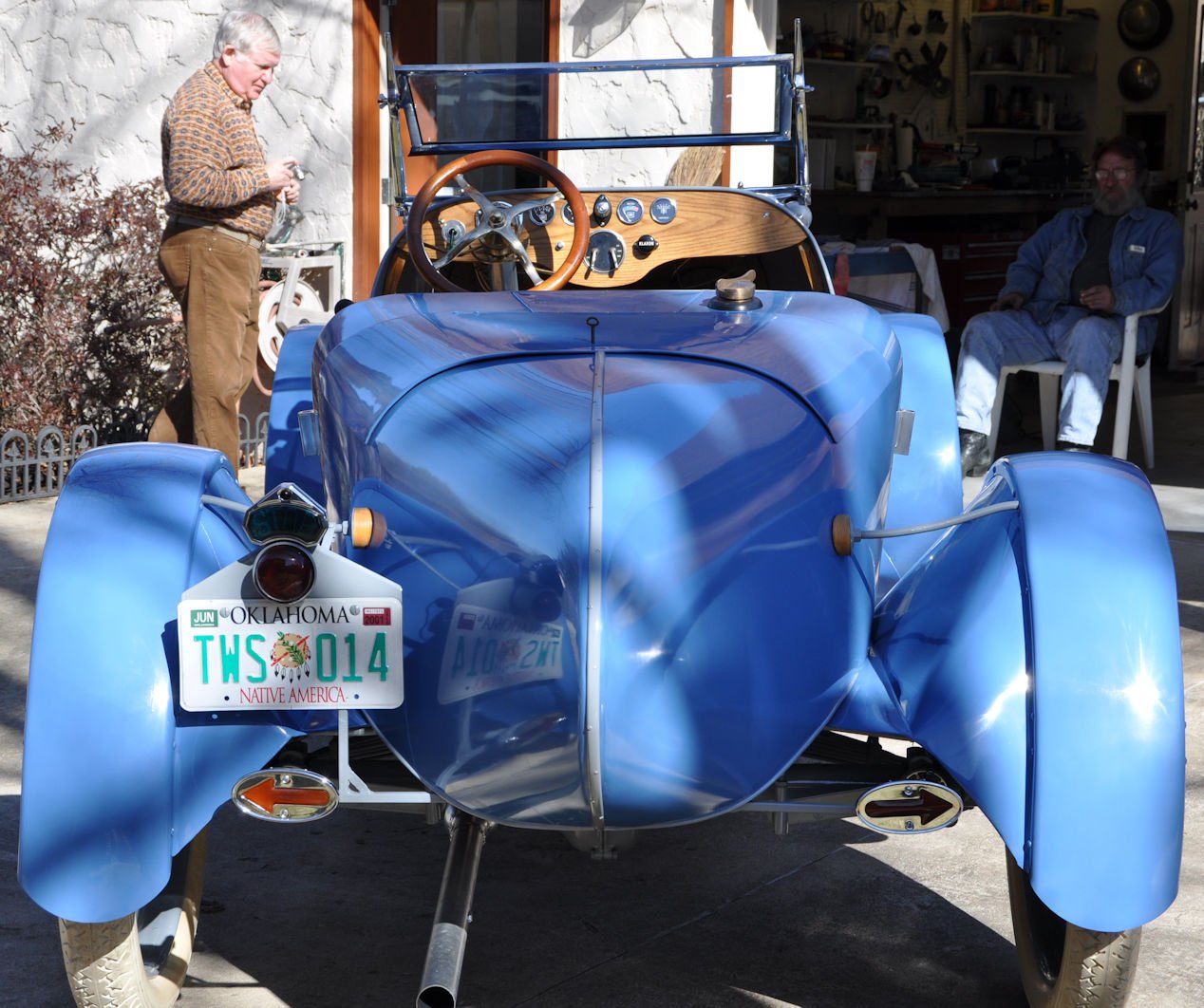

I used the molding from Restoration Supply on my ABC speedster. They have other neat stuff like the Klaxon horn button on the dash. There is wood underneath, so I attached the molding with small wood screws. Larry Sigworth and Mike Bender in the background.
