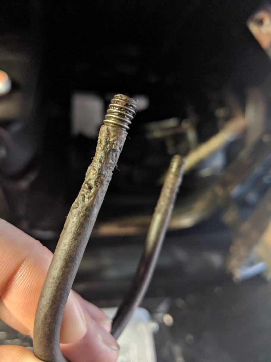

Problem solved. (and no bending!!)
As is often the case, while contemplating this problem during my Sunday morning constitutional a solution presented itself.
I disconnected the rod support u-bolt which allowed me to freely maneuver the rod correctly into position.
Now I just have to get a longer u-bolt for the rod support because the current one is too short to reach the driveshaft tube. Plus, the old one is looking pretty gnarly anyhow.
