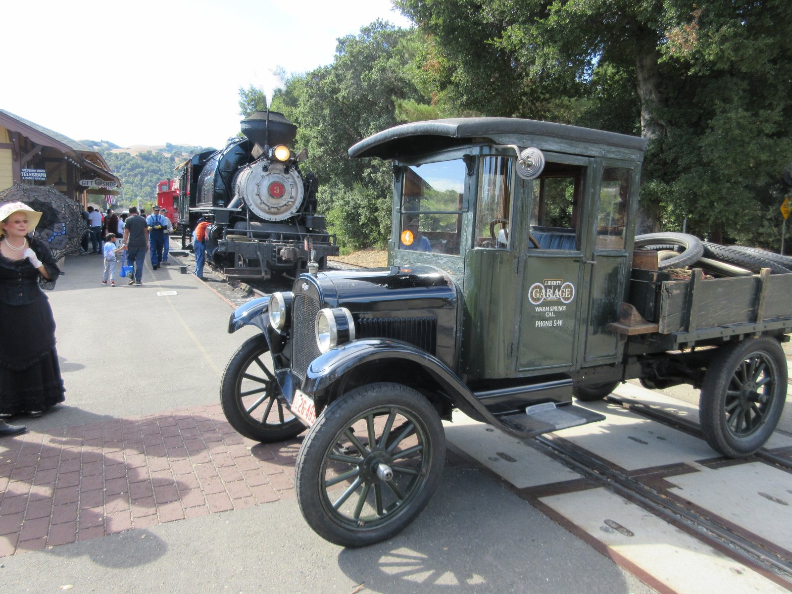

Other than hauling old no.4 to the historic races, the only way I could get a decent ride for daily use out of my Brand X (Chevrolet) one ton truck, was to load it down with antique tires, a monster heavy duty antique floor jack and a few other misc. smaller heavy items. Still feel the bumps but not so severely.
Ed aka #4
