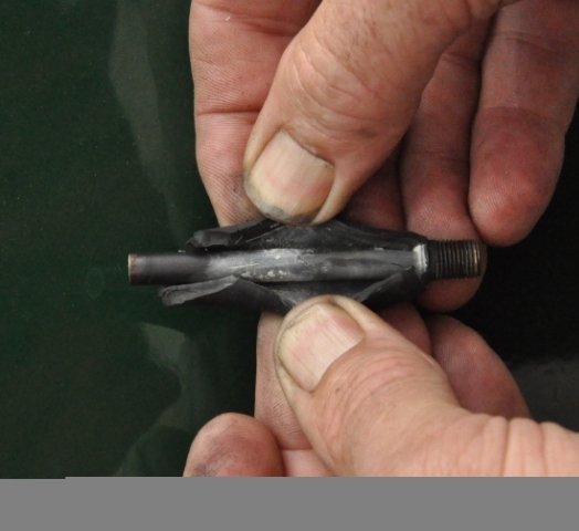

My tires keep rotating on the rim resulting in the shearing of the inner tube valve stem.
I have 30 x 3 1/2 Universal T Driver tires on McLaren wire wheels.
I have been fighting this problem for over five years.
I have a nice pile of tubes with no stems.
I have had this issue with and without flaps.
Just this last week I replaced three tubes and remounted the tires without flaps.
I put 65 – 70 PSI in them.
I made it about 20 miles before the right rear tire sheared the stem while doing about 40 MPH.
The wheel threw the tire and I was on the rim.
It was a real thrill bringing it to a stop with no traction on one side.

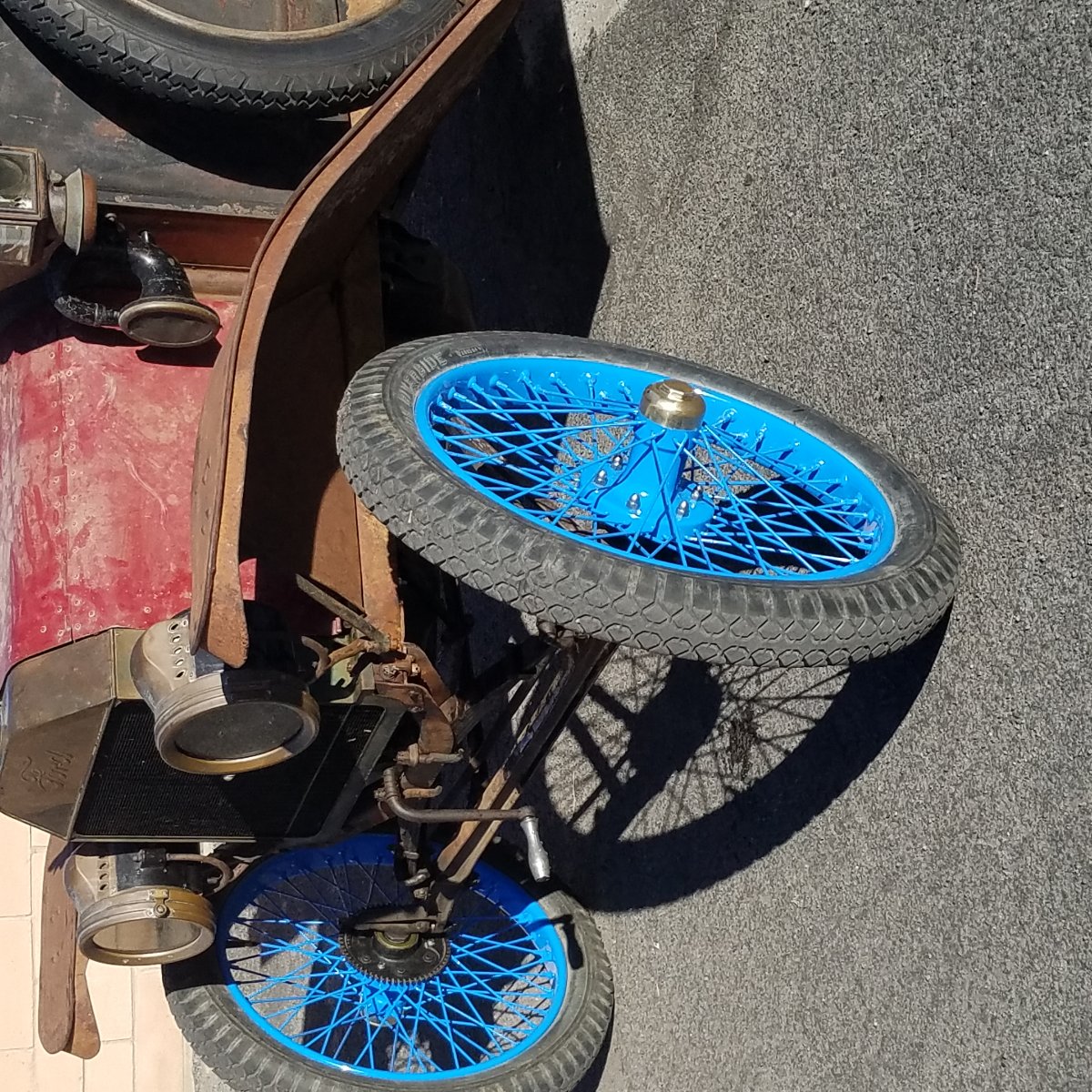

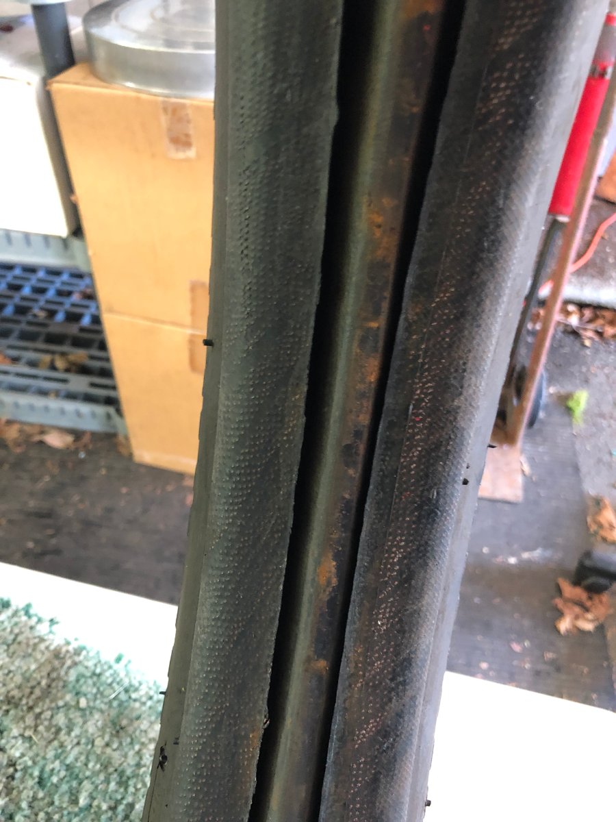

Thanks Scott for the words of encouragement.
Here is a photo of the left side after 20 miles.

Re: McLaren Wires and Universal T Drivers --- Years of Tire Trouble
OK - Here's the photo !!
In this view, the direction of forward rotetion in counter-clockwise

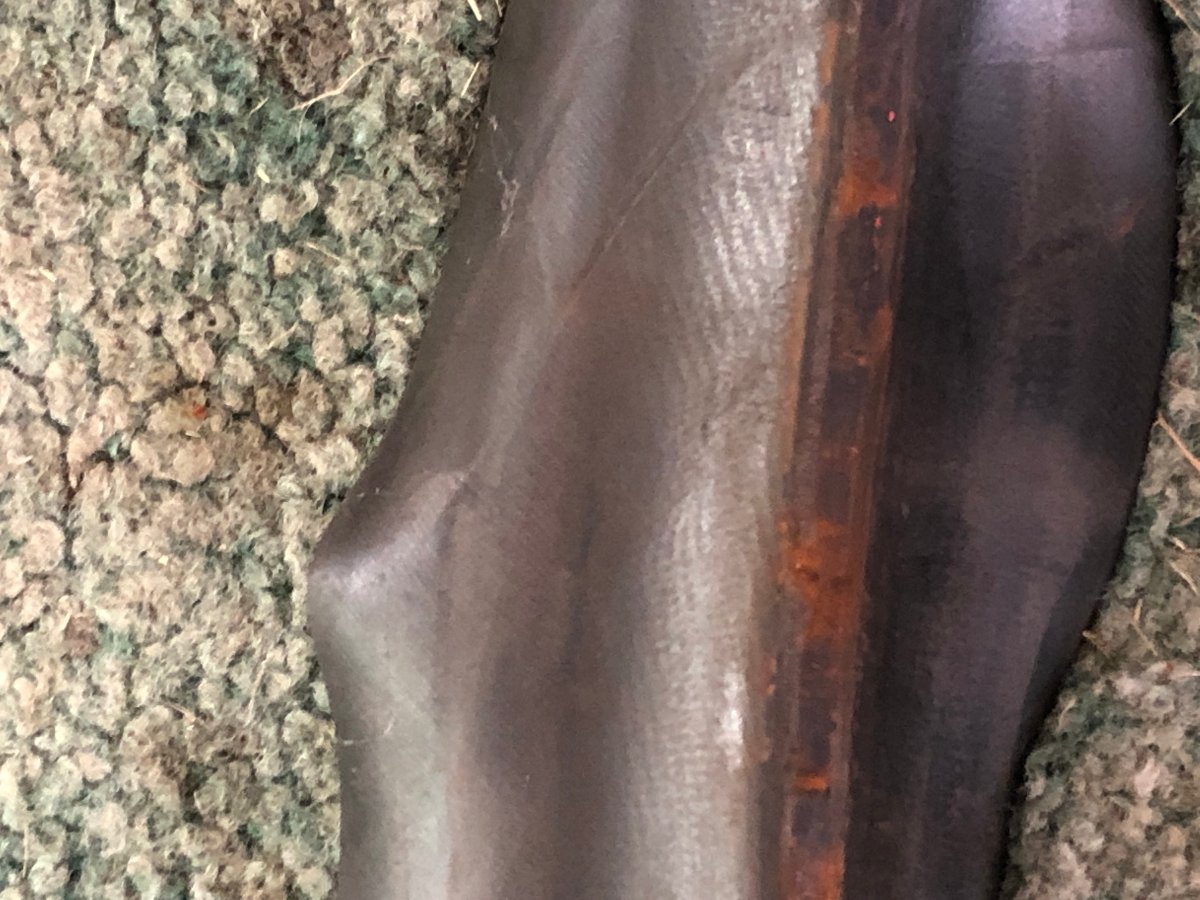

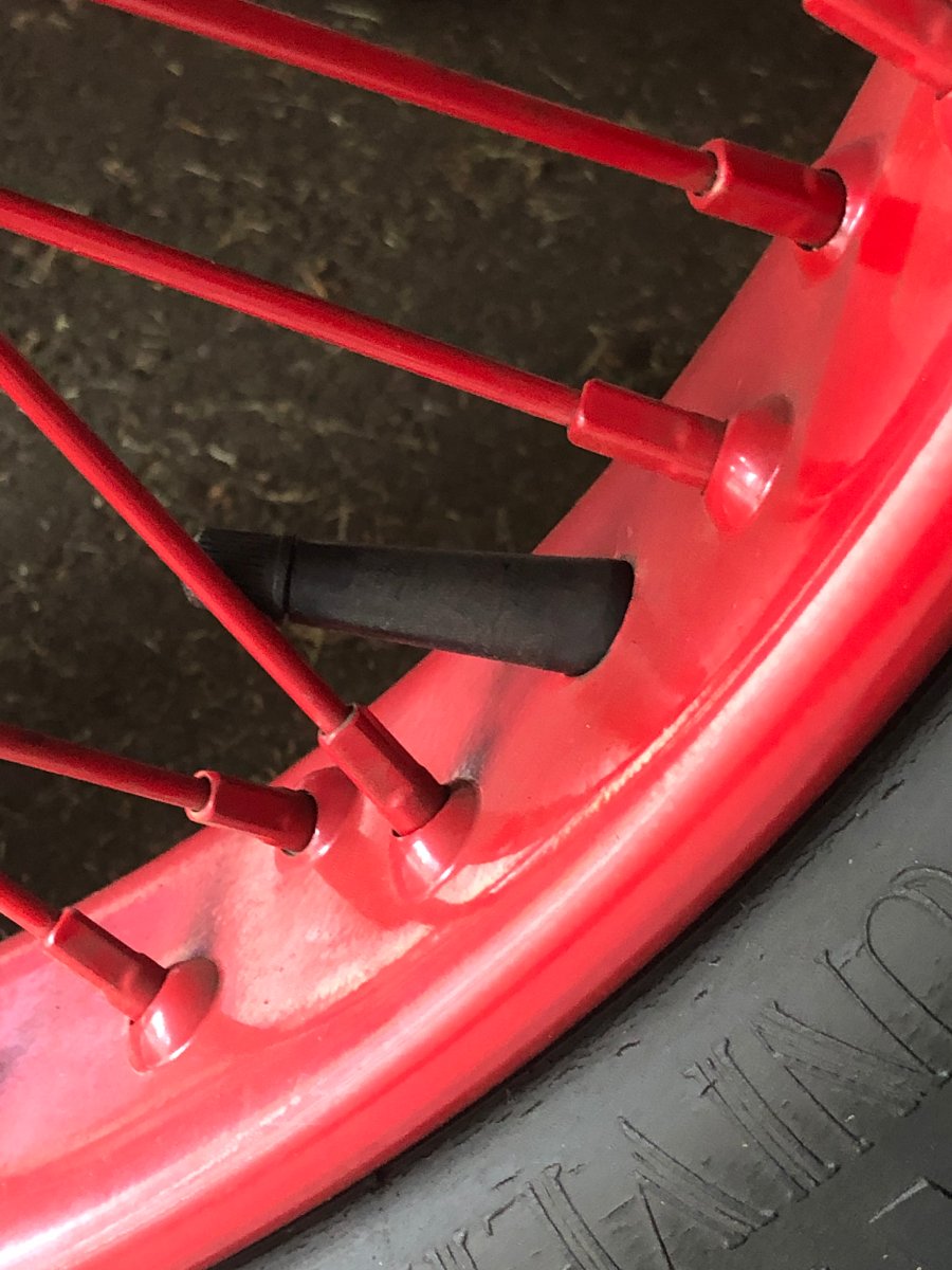

One thing I noticed that will cause the problem you are having is the use of rubber stems. I believe you can eliminate your cut stems by changing to metal stem tubes with bridge washers, locking nuts, dust covers. I run Firestone (black) tires with metal stem tubes on 30x3-1/2 Buffalo wheels using 60 pounds air pressure. Suggest you try metal stem tubes.....they are typically about 2X the price of rubber stem tubes, but they are worth the extra bucks.
tman1913
- Posts: 80
- Joined: Sun Jan 06, 2019 12:30 pm
- First Name: Mike
- Last Name: Bender
- * REQUIRED* Type and Year of Model Ts owned: 1913 Canadian touring, 1924 Roadster, 1926 Mercury speedster, 1927 Roadster p/u, 1920’s bobtail dirt track racer
- Location: Tulsa OK

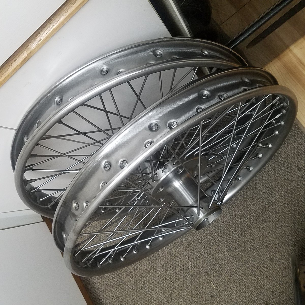

I had the same problem on a early set. The rims were powder coated and that was the issue. I had to use some course sand paper on the inside of the rim and rough it up a bit. Sure solved my problem, many many mile and never cut a stem off.
- Posts: 7413
Original metal stems are often available at swap meets. I buy rubber stem tubes, cut off the stems, and install the metal ones. Much less costly than buying new metal stem tubes. Some details are here: http://dauntlessgeezer.com/DG110.html

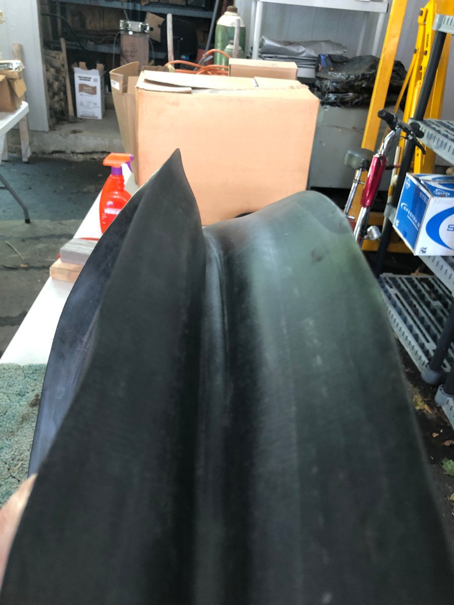

Woah Bob! Dimpled and laced spoke wire wheels and NO flaps. This is just the time they should have flaps. I hope you at least have a good rim liner.

Allen, I do have rim lining.

Bob - I believe the conversation between you and Allen indirectly answers the question. Rim liners will not help in regard to tires slipping/rotating on the rims, but I believe flaps will make all the difference. Flaps are made of pretty thick rubber, and because they become pinched between the rim and the bead of the tire, I believe they will solve your problem. I'm thinking that this indirect suggestion by Allen will solve your problem,....harold

I've had this problem with powder coated clincher rims.
Once I roughed up the painted surface of the rim so the tire could get some grip, the problem was solved.
Flaps do in fact make contact with the rim.
Below are photos of the flaps that were in my wheels.
1. As can be seen by the deformation of the flap, it was pushed down between the tire clincher walls.
2. The red is wheel paint.
3. This is how the flap seated in the tire.
This may be different with other tires.
Respectfully Submitted,

I agree all of the suggestions so far could be the answer to the problem but I see one more possible reason why this is happening and that is the rubber valves themselves. The rubber stems are not good enough to hold the high pressures. Putting the same type tube in ,same pressure and the same result occurs, if this is the problem the tire is going to still loose air no matter what, is roughened or used as a liner.
Sure, using metal valve stems will fix the problem but in the mean time the rubber stems are failing. So if you don't have metal stems you may need to look at the rubber stems themselves.
Putting 60-70 psi is way too much for the valve used on the new tubes we get.
Did the tire rotate and cut the valve or did the valve actually leak out the high pressure so the tire was well under inflated so it no longer had enough air to allow the tire to grip the rim? Any driving braking done when to pressure gets too low and the tire will rotate and rip off the valve. You assume the tire rotated maybe it just lost pressure first.
I found this problem when traveling across the USA in 2008, the valves have a metal stem which is only vulcanised ( or is it just stuck) only around the top end if the stem. Pressure can stretch the rubber and it can reach the tiny area where it is gripping the end of the valve stem. The pressure is so great the air breaks the seal and escapes and down goes the tire.
You can't tell this is happening when you are driving and unless it happens when you are stopped and you are close enough to hear the air leaking out. I had to buy small hose clamps to clamp around the valve stem. Once this is done the tubes will be Ok the pressure stays where it should be ( where you pumped it up to) I still have two tubes with the clamps on them from 2008. At one time I used a piece of welding wire twisted around a valve stem to get me home.
Her is a photo taken on the Pincer Creek tour in 2008 note the valve was cut along the stem, it was easy to peel it back away from the metal stem and only the very end is still stuck to the stem. You can also see the talcum powder which has snuck up along the stem with the air as it leaked out.
- Attachments
- 220951.jpg (66.96 KiB) Viewed 18044 times
- Posts: 7327
Peter, are you saying the rubber stem tubes foisted upon us are not fit for purpose? Who'd have thunk it?

That is what I found on my 33x5 tube on rear of mt TT. The leak was where the rubber meets the brass where the cap threads on. Very small leak. It has been inflated in my shop for 4 days now but smaller " less pressure" than when I put air in. The only way I found the leak was in my horse tank. Very nice tube with no patches. Installing another stem is the only way to save this one.
- Posts: 7327
Dallas, Peter's fix works. I have also used fine tie wire. Two rounds around the stem close to the tube and a repeat about 1/2" further out works well. Neither can be seen when the rims are fitted. Sounds crude, but it does work. Certainly worth doing if you re out on the road and wanting to get home.
D Stroud
- Posts: 1015
- First Name: David
- Last Name: Stroud
- Board Member Since: 2011
Dallas, I agree with Peter and Allan, that fix works. That's the first time that tube has seen daylight since the late '90's. Dave
