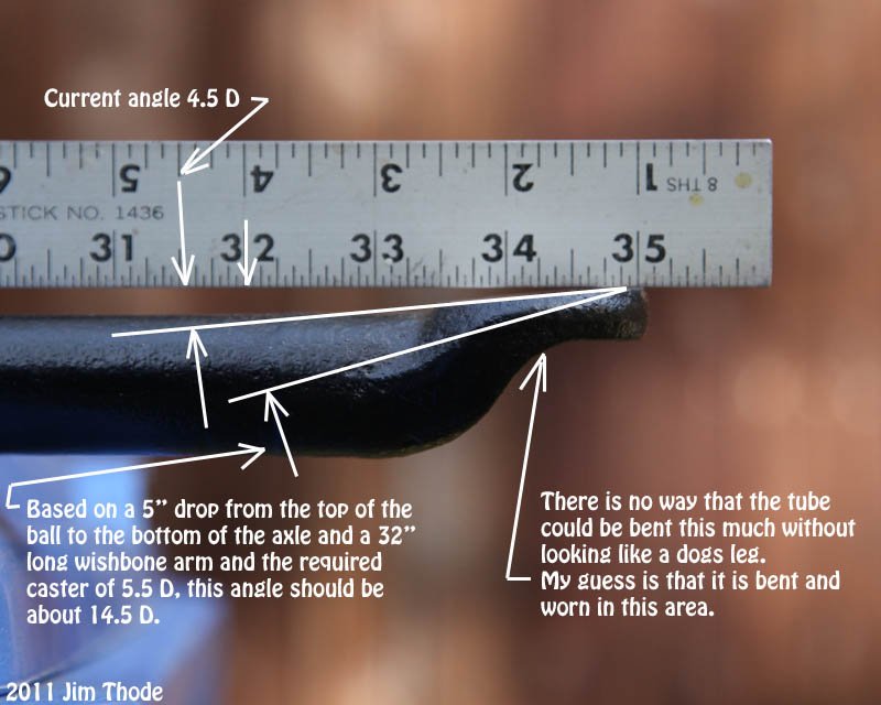

I've been driving my 25 Touring a bit and have to pretty much hold the wheel tightly all the time. I looked under the engine and noticed that one of the radius rod arms has a very slight bend in it. Possibly from a long ago accident I assume. Would that have a lot to do with the car's tracking problem? Also is there a way to straighten the bend? it's not a severe bend, but I can detect it. Thanks,

You need to check all the Ford Specs. I had one which the frame was bent leaving the right side about 5 inches lower than the left. That will cock the wishbone and also the u joint. So the whole car to pull to the side. You need to get the handbook and check all things from the frame to the wheel alignment.Even a spring which has slipped to one side where it is mounted to the frame or broken leaf. A lot to inspect.

My first thought is pressure with a hydraulic jack, and a yardstick to check straightness. That will take three non-yielding holding anchors, one at each end of the bent arm and a solid backup for the jack, facing the bend. If you can take it to a shop that straightens frames, that may be less hassle.

The MTFCA manual on axles is a good start. There is good information on front axle specs and geometry. Checking a frame “in full dress” is more of a problem. Stripped to the frame, it’s not difficult to check for square and straightness of the rails. Others will know better.
As for straightening the wishbone in the car by using a jack, i would be very leery that any force powerful enough to correct a bend might be too much for the connection at the oil pan. Best remove it from the car before working on it I would think.

A bent wishbone will almost certainly affect the caster angle on one or both sides. Uneven caster will cause the car to pull to one side. If the bend is a result of hitting a curb, the axle and pan may also be bent. A bent wishbone could cause the axle to run at an angle to the center line of the car. A Model T in good condition is a pleasure to drive on any reasonable excuse for a road. They have good "road holding" and are quite stable up to and beyond 50 MPH on good roads. If your car pulls, shimmies, wanders, or fights the steering wheel, it needs service or repair.

If it were me I would take it to frame straightening shop or do it yourself. It’s not that hard to do. If you have a stable mounted vise mount it in the vise and use a 2” cheater pipe 4-5ft long and place it over the wishbone and carefully straighten it a little at a time.
Try that first, reinstall it and see how it drives.
If the frame is bent or the axle out of alignment the wishbone would have been knocked out of one or two on the 3 points where it’s attached.
Wishbones are fairly plentiful and usually in good shape too. Maybe somebody has one close to you.

Take it off and lay it on a flat floor. You'll see it.
