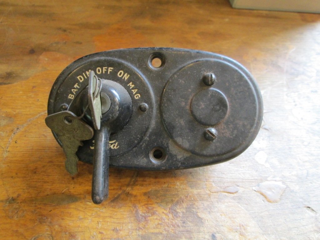

I thought I would add a picture of the 1926 non electric start switch, not often seen.

Very nice !!

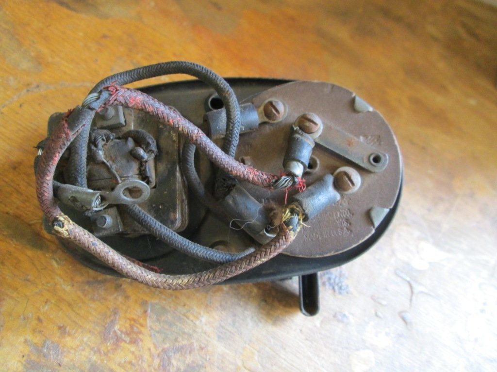

Here's a NOS non-starter switch showing the dimmer resistor - it's going over to the classifieds.
