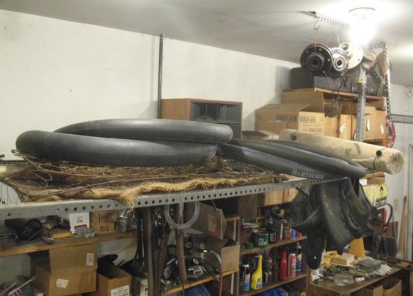

I put in just enough air to keep them round and put them on a high rack in my shop. Considering the exposure to light, maybe I should bag them.

After reading the comments about light and heat, I'm moving my tubes from my shop to the cellar. They will be cool in the summer and above freezing in the winter, and in the dark. But I'll leave them round, not folded.
