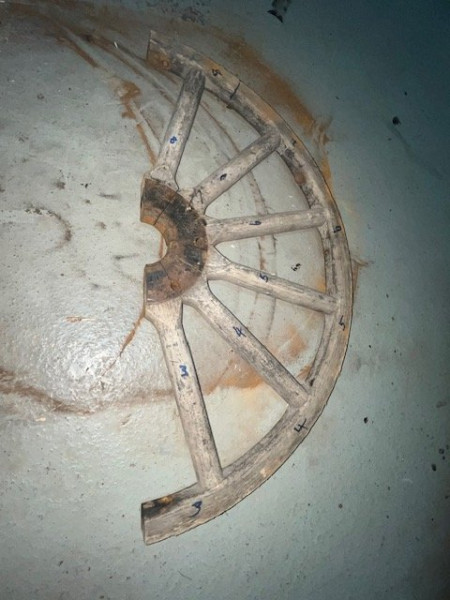

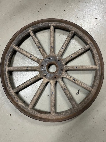

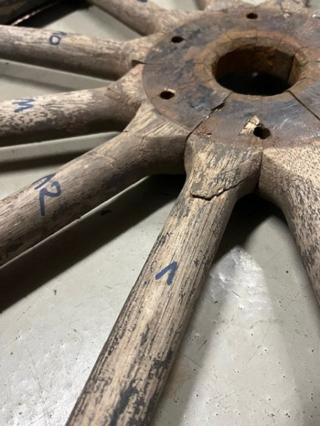

But If you take a closer look at the photos, you could see that spoke number 1 has a crack (which is clearly visible) and spokes 10, 11 and 12 also might have small cracks.
As there is/was no play or movement of the spokes and re-spoking a wood felloe wheel is a big challenge, gluing might be worth a try - for a spare wheel, which I hopefully never need to use.

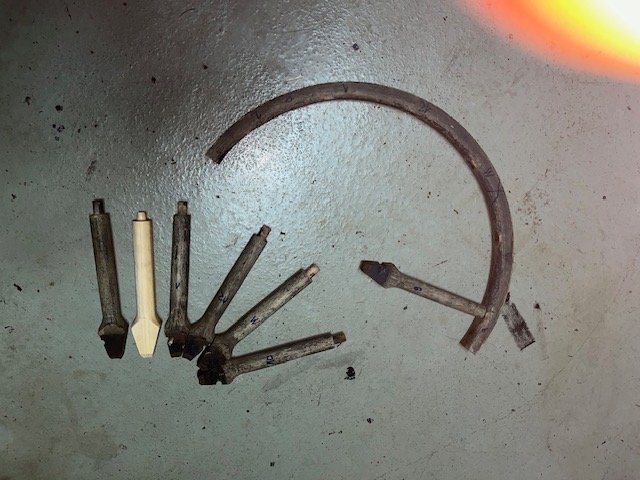

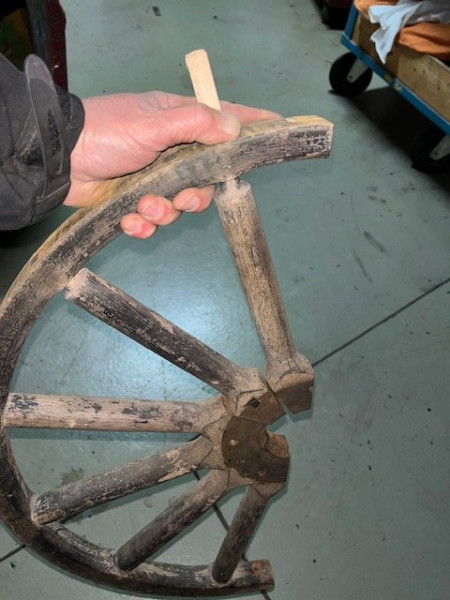

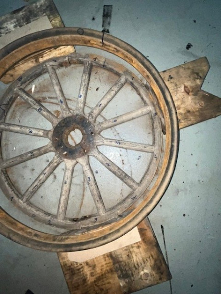

Therefore I removed the 6 rivets and then the felloe with spokes from the rim and also removed the spoke with the big crack and 3 with smaller cracks.
Those need to be exchanged against new spokes, the other seem to be okay and I plan not to touch the half felloe with 6 not cracked spokes.
I have spare new wooden spokes, which I planned to use, but they are too short, too thick and their tendons are not long enough.
Hope to find the right one from Langs or Snyders.
Please find enclosed some photos
Regards, Bernd

The first spoke is removed and all 4 spokes which have smaller and larger cracks.
Therefore I close the here now.
I will ask further questions separately.
Thanks again

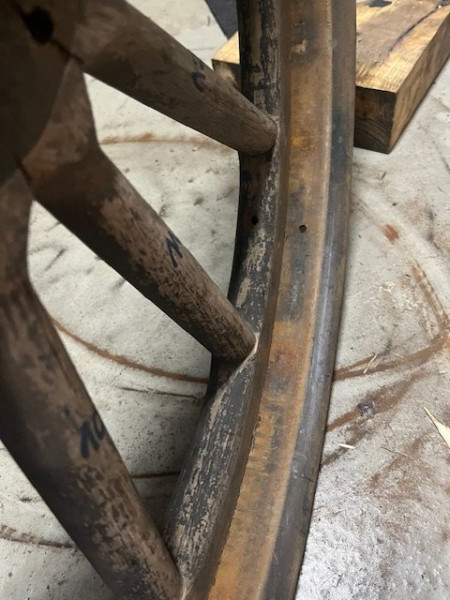

The loose rust dust on the rims indicate to me that the fellows were loose.
Those fellows will need material added to make for a correct tight fit. The fellows are held onto the rim by press/shrink fit, not the 4 rivets alone.
I believe the spokes available are for demount-able fellows.
You will probably need to contact a wheelwright to make you a few spokes.
There are more issues than you realize to get this wheel safely serviceable.
