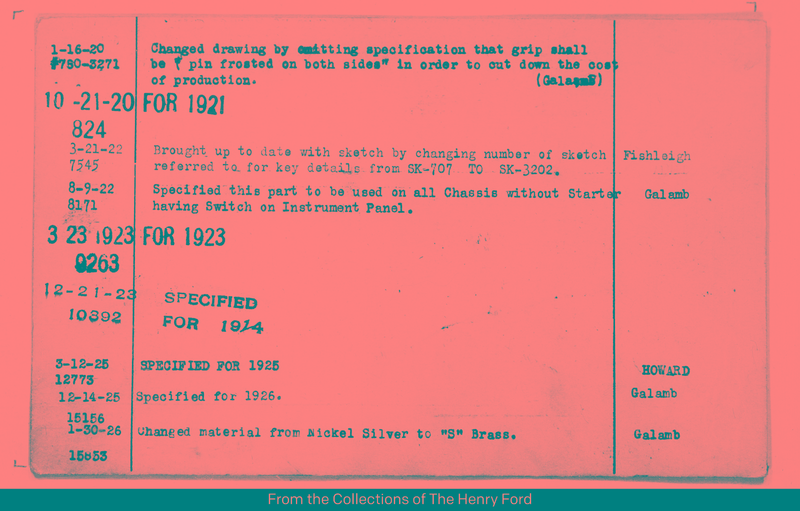

Examples of what you can get by using Benson Ford Research online, via email. In this case the timelines of Ignition Key Changes, for the combo switch plate introduced in 1919. As noted on Record of Change.
Used with Permission of The Henry Ford.
