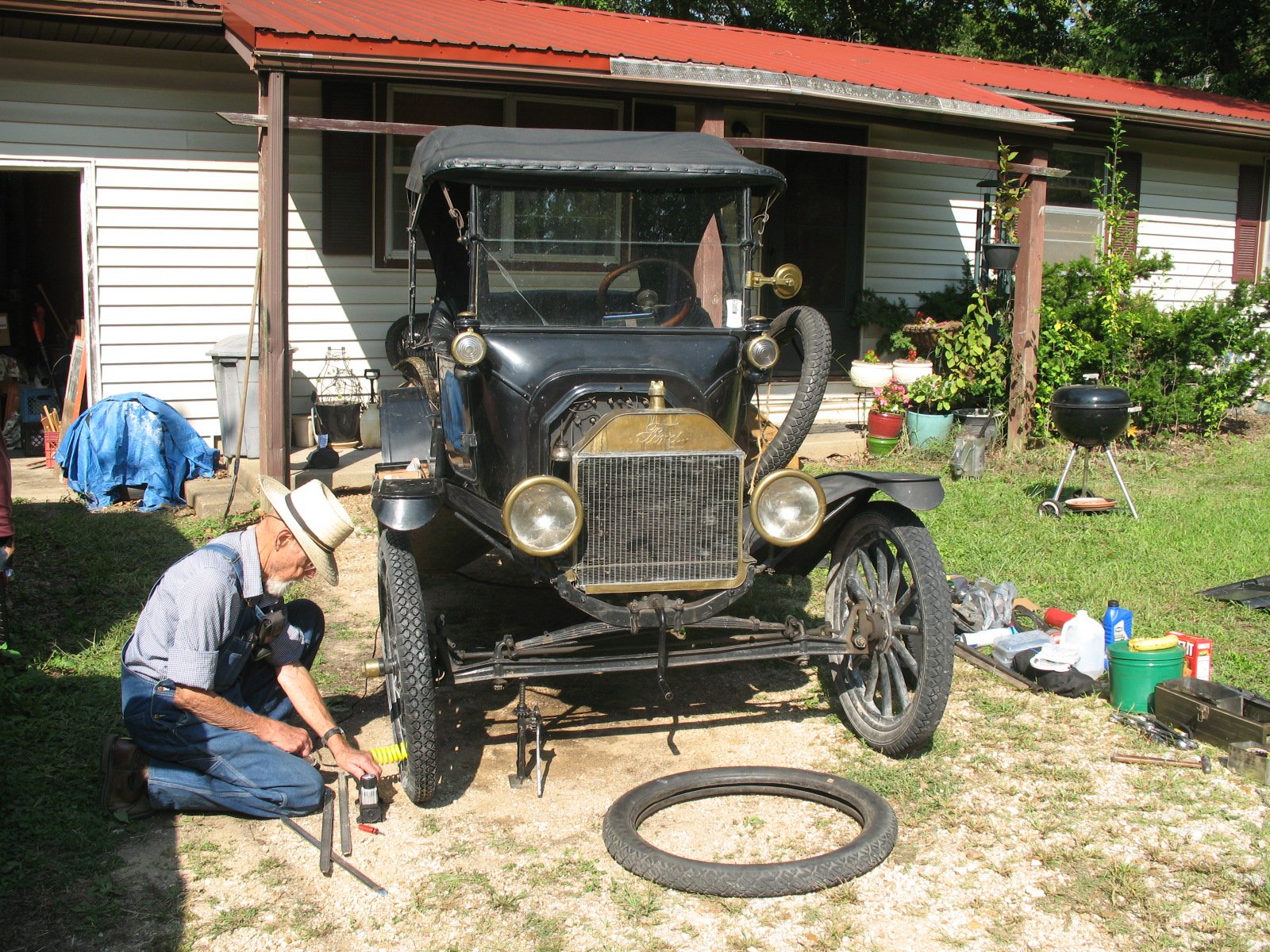

For most people, the first time is tough. That gives lots of us the impression that it's inherently unpleasant. If you're new to this game, don't be intimidated. With practice it becomes more familiar, and you learn some things to do and some things to avoid. The more you do it, the less you will dread it. A few suggestions:
1 Do it on the car, and use the vehicle weight as a handy tool.
2 Use long irons. The "correct" little Ford irons, only a foot long, make changing tires the job from Hell. I carry three two-footers from HF. They are inexpensive and make prying easier.
3 Pry both sides of the tire on or off simultaneously.
There are other details, but those three things will help you turn an ordeal into no big deal.
