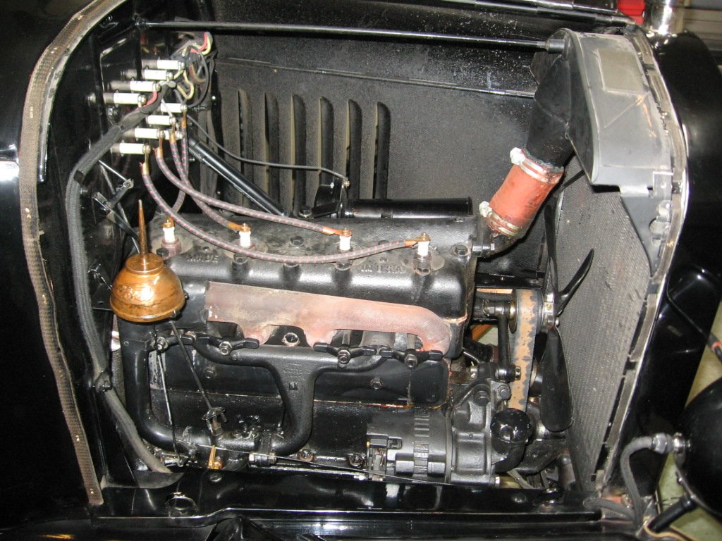

Does anyone have an alternator conversion on their T?
Jeff
Topic author - Posts: 45
- Joined: Mon Jan 07, 2019 9:50 am
- First Name: Jeff
- Last Name: Stevenson
- * REQUIRED* Type and Year of Model Ts owned: 1921 Touring
- Location: Wilder Idaho
Does anyone have an alternator on their T? Buckeye sells them and states this on their website about them:
"The 12-volt version is capable of 80 amp output; the 6-volt version is capable of 40-amp output"
Model T's only have 12 AWG wiring in the charging circuit... and its 100 year old wiring to boot, nowhere near the ability to handle that kind of power if the alternator decided to put out it's max power.
Anyone seeing any issues?
Jeff
Jeff
