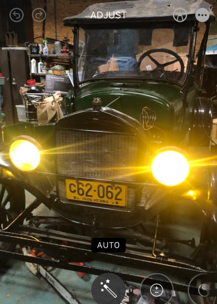

Lighting issue solved !! It was the ground , thanks !! Did the suggested jumper cable test with a fully charged battery and starter turns very slow , so assuming the starter is not working properly

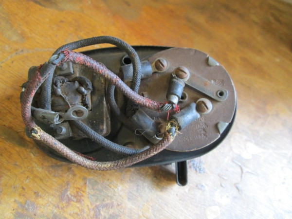

Re: I have a couple Dumb questions
I thought I would add a picture of the 1926 non electric start switch, not often seen.

Very nice !!
- Posts: 5469
Here's a NOS non-starter switch showing the dimmer resistor - it's going over to the classifieds.

Is the floor starter switch original or a repop. Have you checked to see if gets hot?Oldrusty26 wrote: ↑Sun Nov 23, 2025 12:39 pmOk , going to sound dumb here , I’ve just replaced all the wiring in my 26 roadster pickup project, I think my starter is bad as I have made a good clean ground and also ran an addition ground wire from the mounting bolt on the starter directly to the battery . Engine barely tunes and ground is super hot ( brand new battery ) also , a separate issue, my passenger side headlight is very bright and the drivers side is very dim, rotated the plug for the lights 180* and still same issue . Any pointers as to where to go from here . ?? Thank you !!
Oldrusty26
Topic author - Posts: 62
- Joined: Tue Jan 22, 2019 8:13 am
- First Name: Travis
- Last Name: Melnick
- * REQUIRED* Type and Year of Model Ts owned: 26 Rpu 27 Tudor 25 TT etc...
- Location: Waterford pa
- Board Member Since: 2012
Floor switch is an original , ive disassembled and cleaned contact points , the low voltage read was while loading the starter
