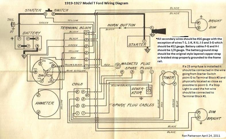

Many years ago I posted here a copy of the Ford print for the 1/0 Model T battery/starter cables
Now I cannot find it!
Anyone got a copy you can direct me to or send me?

Ron: I told you about the company that custom made my cables for me in Redlands. Y&Z's Yesterdays Parts. This isn't the print I know.

Do you mean this ? https://www.mtfca.com/discus/messages/1 ... 1302119578Ron Patterson wrote: ↑Sat Nov 29, 2025 9:50 amMany years ago I posted here a copy of the Ford print for the 1/0 Model T battery/starter cables

Re: Help
No.
It is a copy of a original Ford factory drawing T-1891 or T1899 battery to switch and switch to starter cables.
There is note on the drawing similar to this: "1/0 starter cable consisting of 19 strands copper wire, single covered with insulation cambric .012 inches thick. Spiral wound with minimum lap of 1/8 inch, with single stranded corded braid prepared with waterproof saturation. Outer layers of wires to be right-handed lay."
Ron P.

The current reproductions would be adequate if they were the proper length and had the ends installed properly in the proper orientation…
