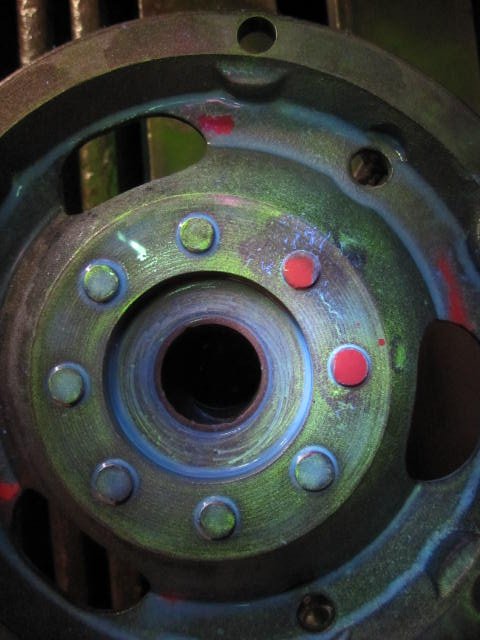

If the rivets are loose I would recommend you check the plate for cracks as they crack between rivets.
- Posts: 5459
- Last Name: Hatch
- Location: Alabama
Re: Driving plate rivets dimensions?
Having found many, many driven plates cracked I have wondered if they could be repaired. Has anyone ever tried using the Loc n Stitch method to repair one?
How about welding? Or any other method? Dan
- Posts: 5199
I have seen these drive plates with 3 1" welds between the shaft flange & plate.
I like the added rigidity. Those few cracks become irrelevant.
