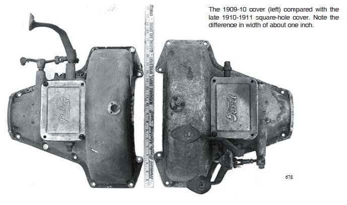

Some early cars used a slightly different size / shape oil pan / hoggs head cover bolt pattern.
It also may or may not clear the teeth on the flywheel die to a slightly different shape. Anything is possible, how much do you want to change / how hard do you want to work?
The amount of work needed and value of the original early parts is why most of the time it is just swapped for a later engine.

Mike is spot on. If this engine has a narrow one piece pan you’ll have to swap the pan to fit a starter hogshead. The other option if your lucky is to locate a working starter generator that mounts to the left side of the block. Most I’ve seen have a sprocket mounted on the crank & is chain driven. They are out there just need to find someone to part with it. I believe Jack Putnam had a T that he place one on. Somewhere I have a few pictures I saved. Best John

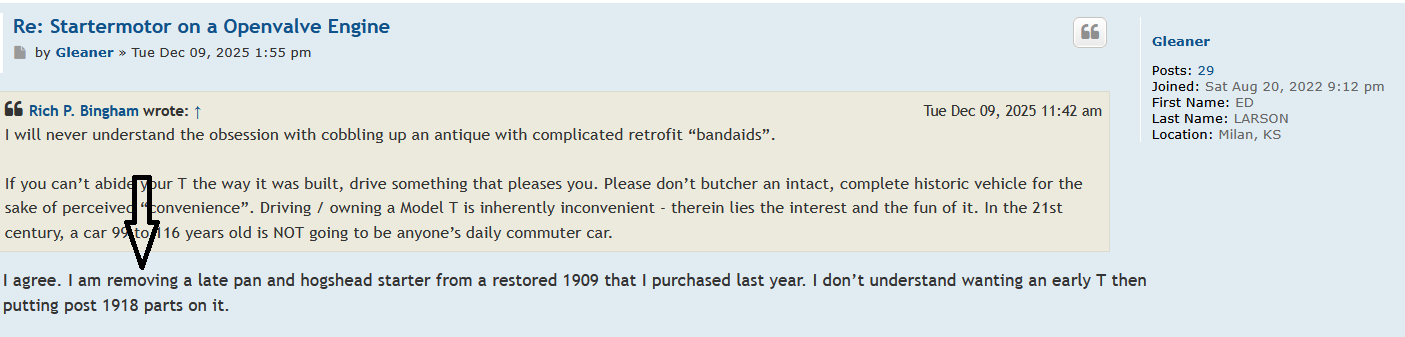

I agree. I am removing a late pan and hogshead starter from a restored 1909 that I purchased last year. I don’t understand wanting an early T then putting post 1918 parts on it.Rich P. Bingham wrote: ↑Tue Dec 09, 2025 11:42 amI will never understand the obsession with cobbling up an antique with complicated retrofit “bandaids”.
If you can’t abide your T the way it was built, drive something that pleases you. Please don’t butcher an intact, complete historic vehicle for the sake of perceived “convenience”. Driving / owning a Model T is inherently inconvenient - therein lies the interest and the fun of it. In the 21st century, a car 99 to 116 years old is NOT going to be anyone’s daily commuter car.

It is at the owner of the car to dicide if he want an electric starter or not on his car, even if it is a car before the starter area.
I did this for me on my three Model T (1926; 1922 and 1915).
The raison was easy:
In 2010 I had my third back surgery with a fusion between L3 and S1. Now 15 years later the back pain is still there every day.
The surgery made me walk again but it didn't replace or repair my bad back.
One of the problems was and is still the cold crank start of my Model T's. There for I have an electric starter on all my cars and yes also on the 1915 touring.
In the past, I did this on a 1912 right hand (English) Touring and a 1911 Torpedo.
For the touring I changed all the needed parts on the original engine. (Thanks Toon for the Hoghead.)
For the 1911 Torpedo, as it is a weekly driven car (also in the winter), I rebuild a complet 1919 engine and swaped it with the original 1911 engine (not open valves engine). The orginal engine is stocked in a dry warm garage and surely not for sale, it will stay with the car.
Just my opinion.
Toon I see you next Saturday at Bergambacht during the technical afternoon.
Andre
Belgium
