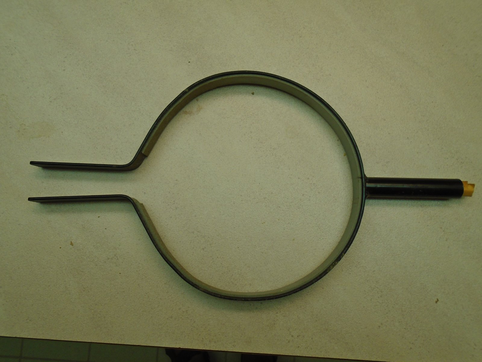

I have used this style of rim remover with good success.
