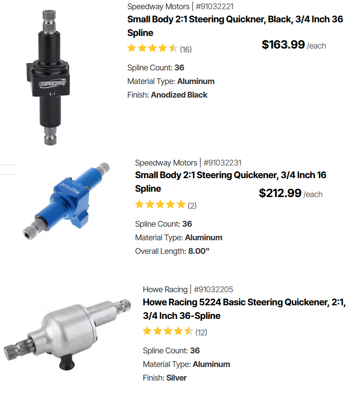

There are 2-1 quick steer boxes that can be put on in backwards to make Model T 8-1 or 10-1 steering ratio
https://www.speedwaymotors.com/Search?q ... Components
