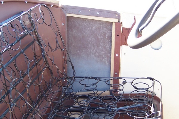

If the original owner used a wood frame, that could be the cause. Or put plywood over the spring? Or stuffed the spring coils with upholstery foam, some may do that for extra support to worn coil springs.
The '26-'27 front cushion is only the spring frame, covered with the upholstery.
The cushion then fits into the metal body seat frame. Have seen some use a wood base, but not original.
Perhaps your spring may be incorrect for the '26-'27.
To fit the seat upholstery in the factory, the covering sewn assembly was fitting by compressing the spring, so that the hem of the assembly could be crimped into the channel of the spring.

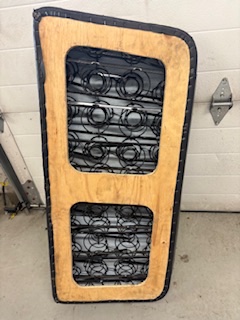

If you send pictures of your seat frame and cushion underside then maybe we can figure out the best way to fix it.
Mike

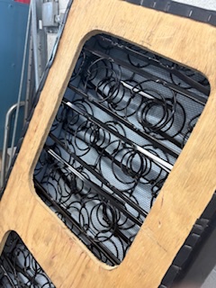

You are correct, the last owner used plywood on the bottom beneath of the springs, this in itself adds will add 1/2” of height.
Looks like I need to take the seat apart and see what is on the top side of the spring package

Post by Dave1 » Thu Dec 18, 2025 2:02 pm

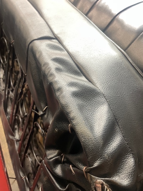

[image][image][/image][/image]

Re: 26 touring seat height

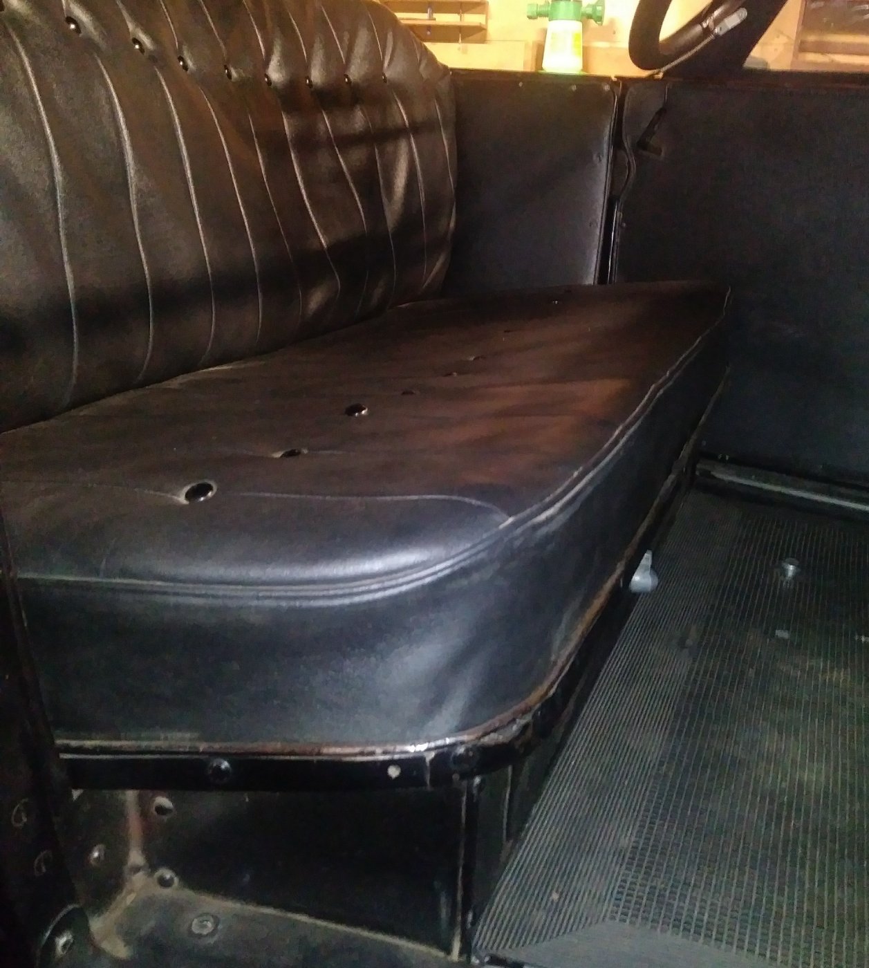

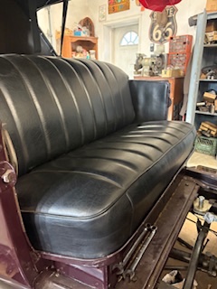

Post by Dave1 » Thu Dec 18, 2025 2:08 pm

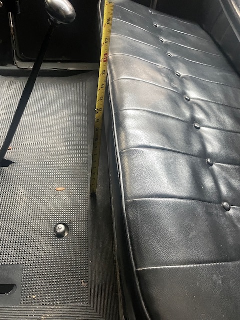

Post by JohnM » Thu Dec 18, 2025 2:43 pm
Dave, your seat upholstery looks to be well done with more padding than most. It's a shame to take it apart, but the comfort from extra padding is pointless if you can't sit in it and drive.
Here is a picture of my front seat. It is showing some wear but you can see the difference in height.

Post by Mike Silbert » Thu Dec 18, 2025 3:55 pm
What a shame to have to "fix" that, looks like a really nice comfortable seat.
The plywood underneath does not belong and the padding is overstuffed.
