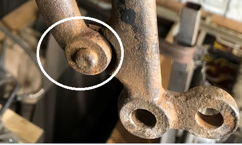

1917 spare tire mount
What does the spare tire mount look like and how does it mount on a 1917 touring car?
I picked up one at an auction, with 2 ears cut off but don't know if it is correct or where it attached.

Re: 1917 spare tire mount
They didn't have one, because they were still using non demountable wheels.
There was none. Non-demountable wheels. Aftermarket had tire holders mounting on the left running board.
The fully equipped car carried both different sized, front & rear sized tires.
As posted above, no carrier on a 1917 frame, as demountable rims weren't available yet. So most times a spare tire was strapped to the running board, some mfg. supplied brackets even for the rear mounted to the spring clip.
Only the late '19 frame had holes for the tire carrier.
You could drill holes in your frame to use a demountable rim/ tire carrier.
Aftermarket companies made carriers for demountable rims.
And for only the tire without a rim, plain tire holders were made to frame mount.
