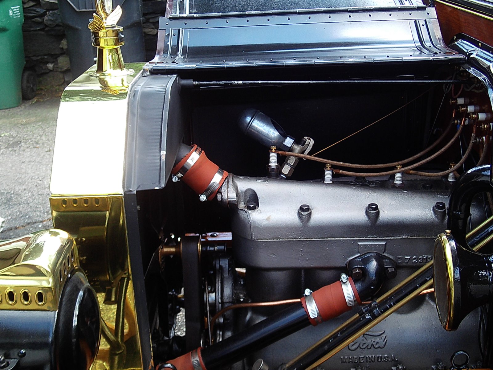

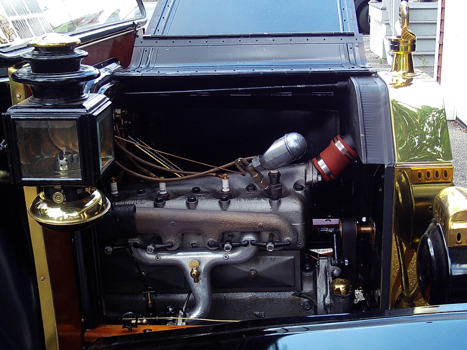

Here is typical brass radiator on a low head with low style cylinder head water outlet to the radiator.
And the factory design of the neck into the upper tank is offset. That mates with the cylinder head as the water outlet bolted there is offset in relation to the head and engine block.
Note rear panel of the upper tank on the right of the photo, the outlet is slightly offset left-to-right, in relation to the radiator support rod to the dash.

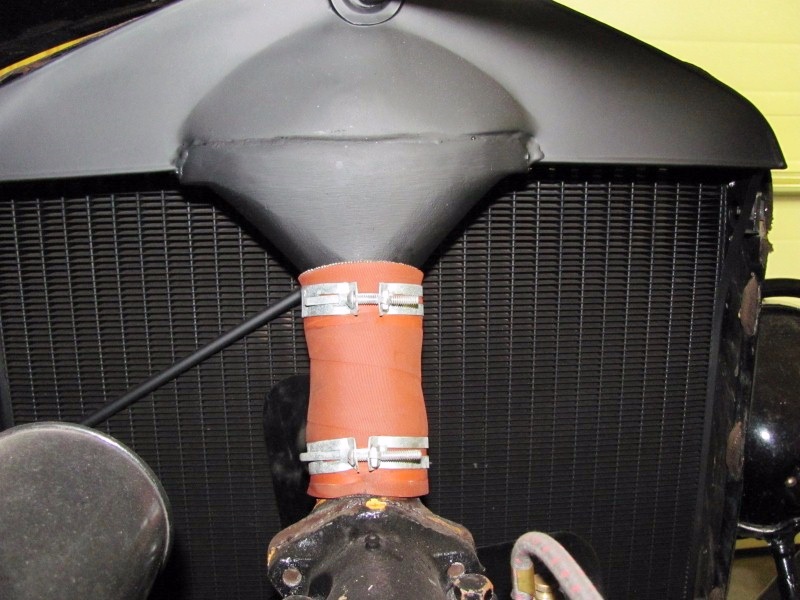

And this is Berg's black high radiator, similar position as factory, slight offset to mate to cylinder head.

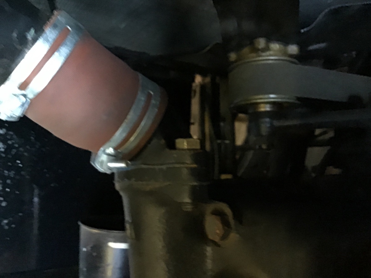

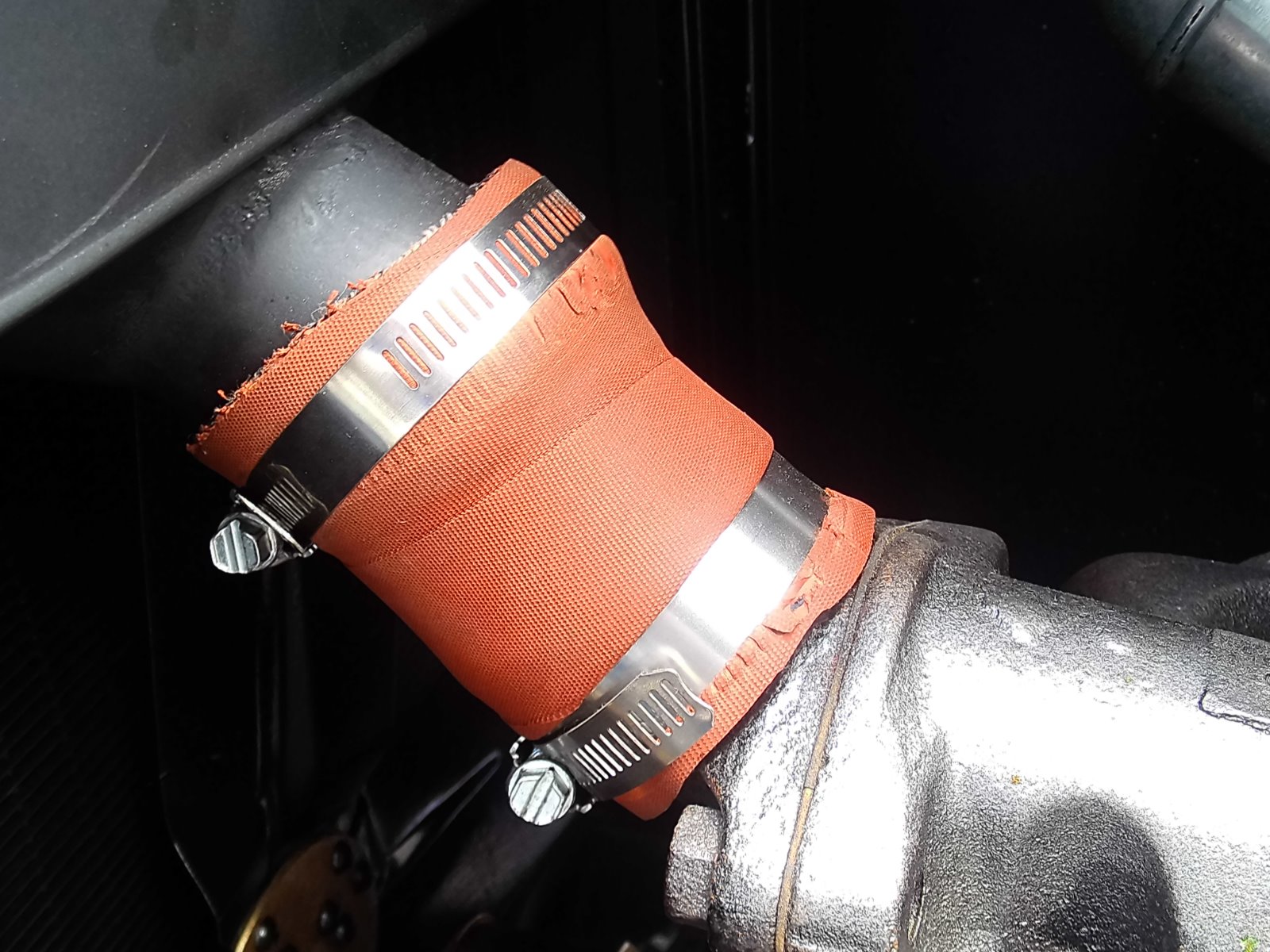

Here are some pics of my issue.

does the clamp tighten down enough for it not to leak?
- Posts: 7411
Re: New Brassworks Radiator
As Dude Lester said, "It don't hurt the runnin' of it none." As long as the hood fits correctly and the hoses don't leak, I say close enough for gummint work. The change I would make is to ditch the modern clamps and use something close to the original Ford clamps. I think mine are pretty close, though I do cheat and used filister heads so the screwdriver can get a good grip.

All that extra stress on the inlet isn't cool. Is that just a brass tube soldered into brass sheet? The original inlets were a heavy casting with a generous flange and probably more apt to take stress (though at least there wasn't alignment stress present as seen here), but on a set-up like that I'd expect something to fail eventually.

From your photos, it appears there is no lock nut to distance the radiator rod the correct amount from the firewall. There should be 2 lock nuts. One at the firewall, the other at the radiator. I dont see the one at the radiator in your photos. Setting the correct distance is simply a matter of screwing the rod into the radiator the right amount and using the lock nut to keep it in place.

It looks like the inlet that bolts to the block would be high, compared to the head, if it was not bolted to the head and the hose was connected to the radiator and everything else was in place, is that correct?
When did you buy the radiator and what vendor did you buy it from? I had a similar issue earlier this year, I'm trying to understand if your issue is similar .
Have you contacted Brass Works or the vendor you bought it from yet?

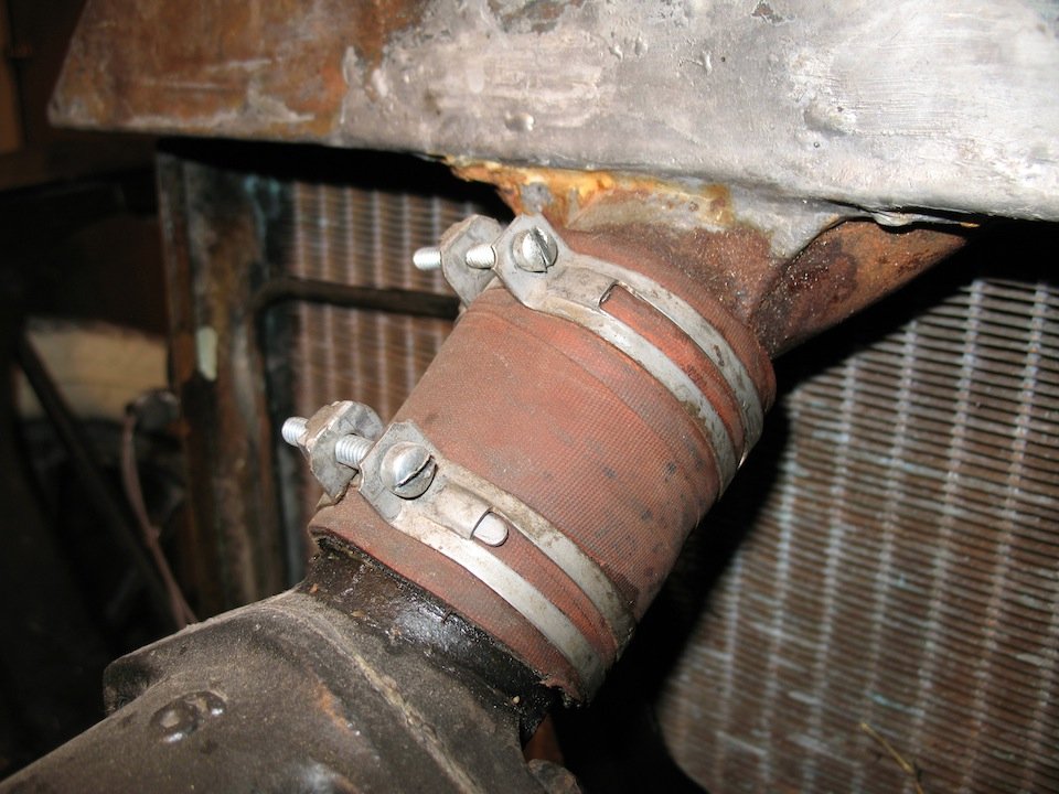

I came across this picture this evening and it reminded me of the question of whether the radiator rod should have two lock nuts. This is the famous 1917 Rip Van Winkle car. Maybe this also says something about the old question of whether engines were painted.

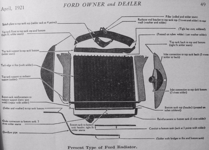

Scott, my experience differs. I have found stripped rods/castings on two radiators over the years.
The casting on the tank is solidly riveted in place. Solder is used to strengthen and seal the joint. Then an added washer is soldered to the outside of the tank to seal around the casting and further strengthen the fixing point. What has developed is a strong mounting point for the rod.
The issues with frame wracking and vibration are addressed by the two point mounting of the radiator on spring loaded studs. The radiator is not 'fixed' to the frame. It is free to move on its mountings as the frame flexes. The later style of mounting has the radiator supported on springs on top of the frame, as well as the springs within the frame allowing the studs to absorb stresses. With the length of the radiator support rod, and its flexibility, I doubt that any frame movement will allow the radiator mountings to transfer damaging loads to the rod mounting.
If any twisting load on the rod was considered enough to compromise the mounting at the radiator, I would be inclined to leave the firewall end of the rod just loose enough to allow the twist.
A very good possibility is that someone in the past changed the front crossmember in that car and mistakenly used a TT crossmember. The original radiator was then found to have exactly the same issue, and eventually the radiator inlet was modified to fit correctly.
I've seen mismatches at the top hose due to incorrect cross member several times, but so far only on the later “black radiators”. The usual mismatch on the later radiators would be about an inch. It makes sense that the same mismatch on the earlier radiator would be a bit less because of its shallower angle.
