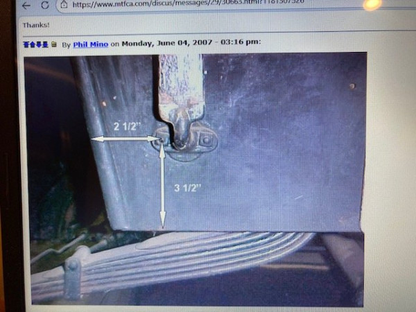

Friend has a 10 body that never had a tail light and needs the measurements for proper location for the mounting bracket. Thanks John

John, is the touring taillight bracket location the same on a 10 as an 11? I found a post from MTFCA June 4, 2007 1911 taillight and speedometer location, that shows the measurements of the bracket location. I saved a screen shot of the 1911 measurements pic I think I can email you if this helps.

Here is a pic of the 11 location.
