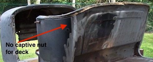

I think factory RP didn't have the 2 bolts on each side to bolt the turtle up to the body.

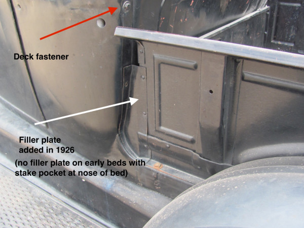

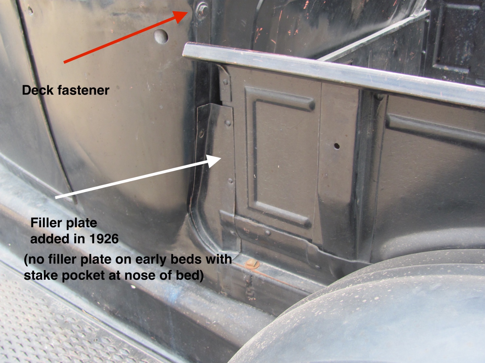

- Posts: 5579
Re: Factory Roadster pickup or Runabout
Look at the bottom photo Dan posted - they're visible near the top & middle of the panel.

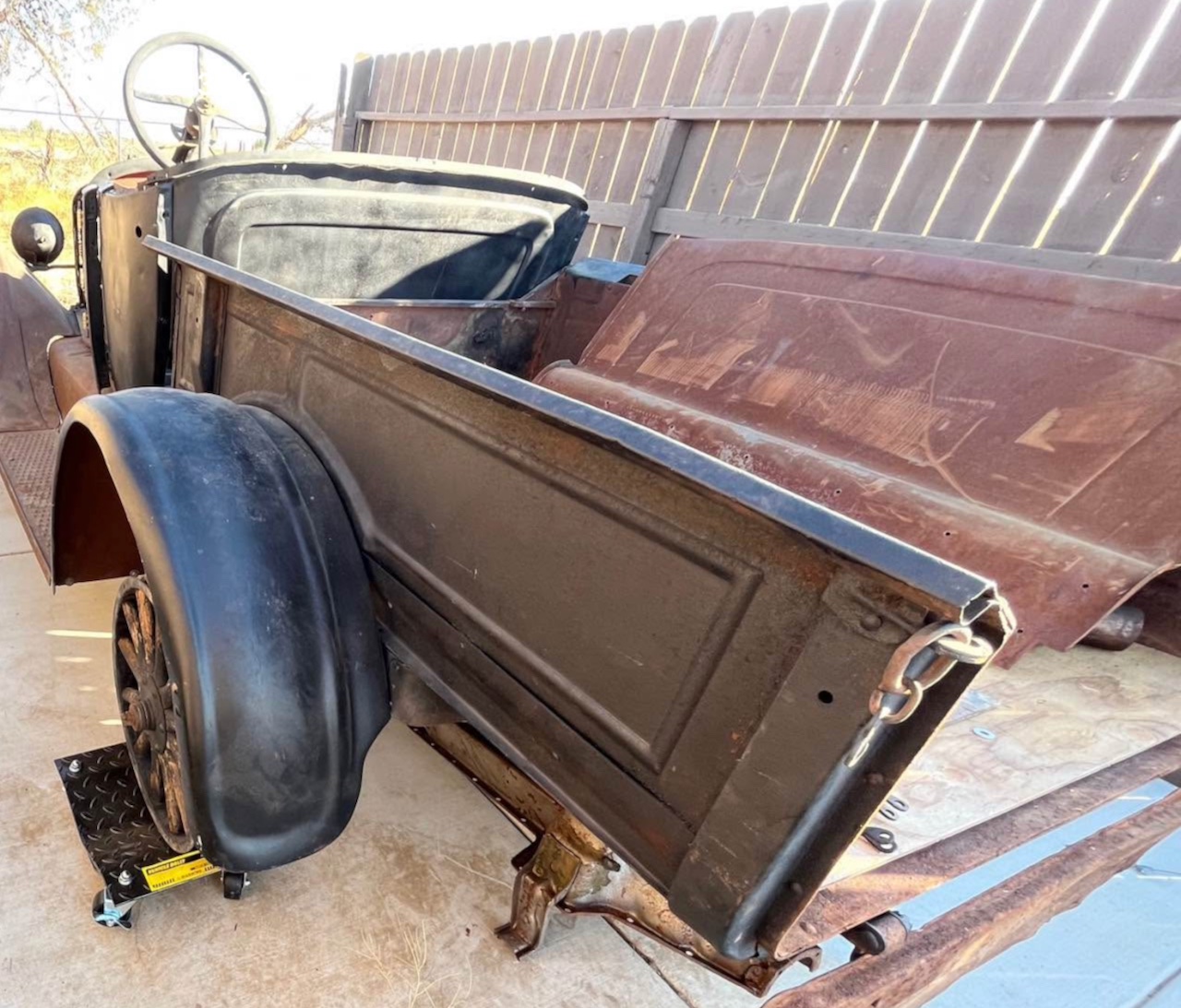

These noted photos may help.
Early model 1926 pickup illustrated with Ford adv., note the front stake pocket is at the very front of the bed,
a change was made later to move pocket back about 7".

Thanks everyone I just looked at my truck and looks like mine was originally a runabout there are two bolts on each side of the back of the cab there is also a filler plate that has part of the lip bent back to clear the the bolt head also the front stake pockets are also further back so I assume it’s the later bed so either the dealer installed the truck bed or somebody else put it on later between 1926 and 1961 because I know the bed was on the truck when a previous owner purchased the truck from a copy of the typewriter letter I have dated 1961 saying it was a truck
