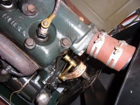

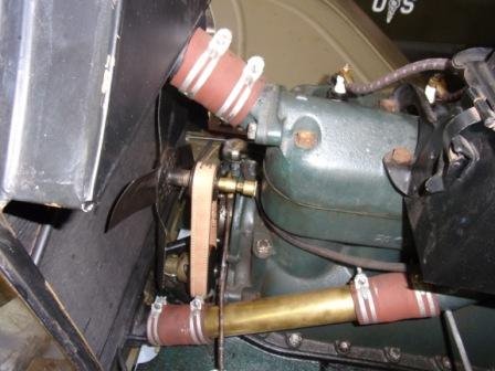

Got the 25 7/8" leather fan belt from Lang's in super short time and put everything together. Snugged up the belt with just enough tension to take the stiffness out of the belt and still turn the fan. Cotter pin in fan bracket bolt and had to remove the crank knuckle to get the stiff belt on, so new cotter pin down there as well.
Big car show tomorrow with lots of
fan bracket 1.JPG (40.13 KiB) Viewed 5551 times
hand crank starts, so I'll check tension again when we get home.
Thanks to all.
